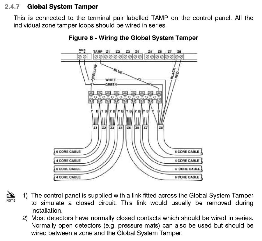

The first four control panels out of the blue I've looked at (TS500, Veritas 8, ADE G4 and Menvier 510) do not seem to use any resistors as far as I can tell from their manuals. They seem to have a global tamper circuit that means you have to string together lots of detection zones with solder, blue tack or spit.

If you are going to use global tamper, don't use solder, blu-tak or spit. Use a choc-block in the panel to daisychain the tampers, each terminal having two wires in it (on the same side). The first terminal has one side of the global tamper and one side of the Zone 1 tamper. The second terminal has the other Zone 1 tamper and the first Zone 2 tamper... (repeat) ...the last terminal has the other side of the last zone and the other global tamper.
By doing this, you have a better chance of finding a tamper fault (mouse-chewed cable?). You can use your multimeter, set to read voltage, across each zone's tamper connections in turn to find out which one has voltage and is, therefore, open circuit. Good luck if the fault is intermittant or on more than one zone!!
Like so?
I find it odd that the choc block isn't part of the panel. There's plenty of room for a larger PCB and a few square inches of fibre glass doesn't cost much, especially in the context of time is money.
Yes, like so.
You only need the choc block if you're wiring the global tamper in the panel. It is also possible to "daisy chain" zones (don't do it!!) and then the tampers would be linked in the detectors/contacts.
If you don't like it, get a different panel, there are dozens/hundreds out there. research first.
