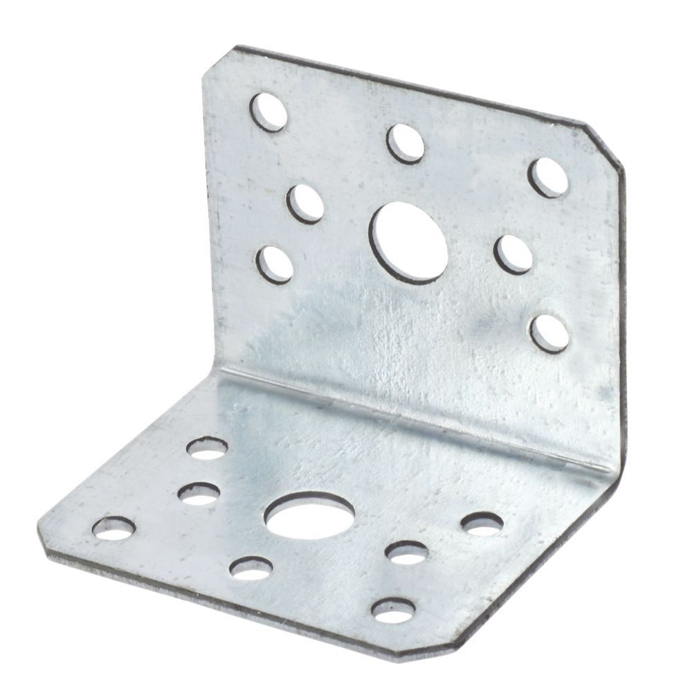

Why not use heavy duty Angle Brackets at the top and bottom of the cupboards. , can be chased into the wall, neat and inconspicuous
