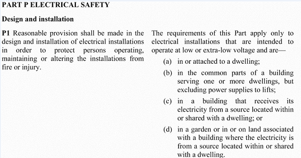

It bypasses Part P, or so I was told on a garden forum, because the armoured cable runs from a household socket.
That's a good example. I know what you mean - but you don't. :)
New circuits are notifiable to the Building Control. Extending an existing circuit is not, but it makes no difference to a registered electrician.
However, that is nothing to do with Part P.
Part P: This is it in its entirety. There is no more.
