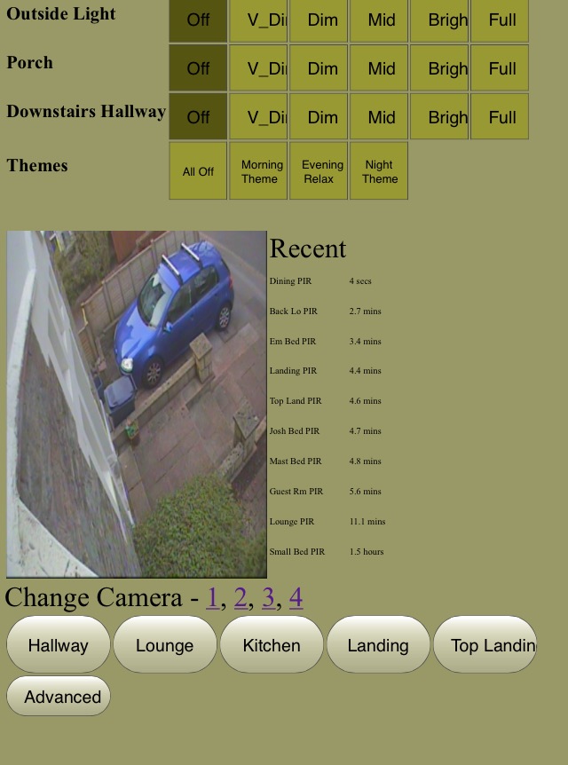

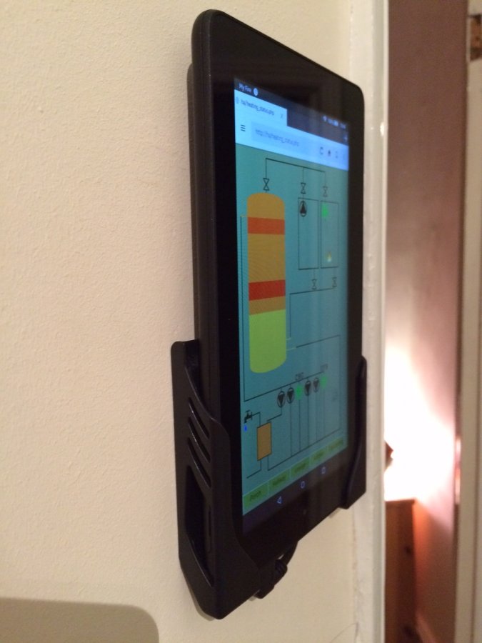

I did something similar to Galaxyguy with my Gal96, except I use the serial lines as I don't have theIP board in mine. I wanted to be able to get my home automation pages, cctv and alarm status on one page, which I've done, I run this in various places in the house on kindle fire HDs which I have wall mounted.
