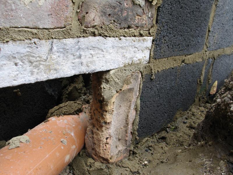

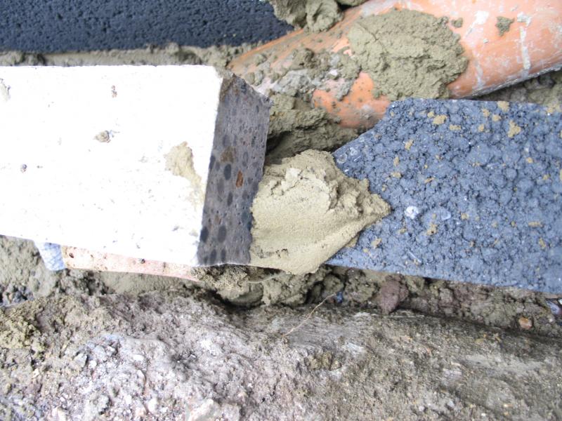

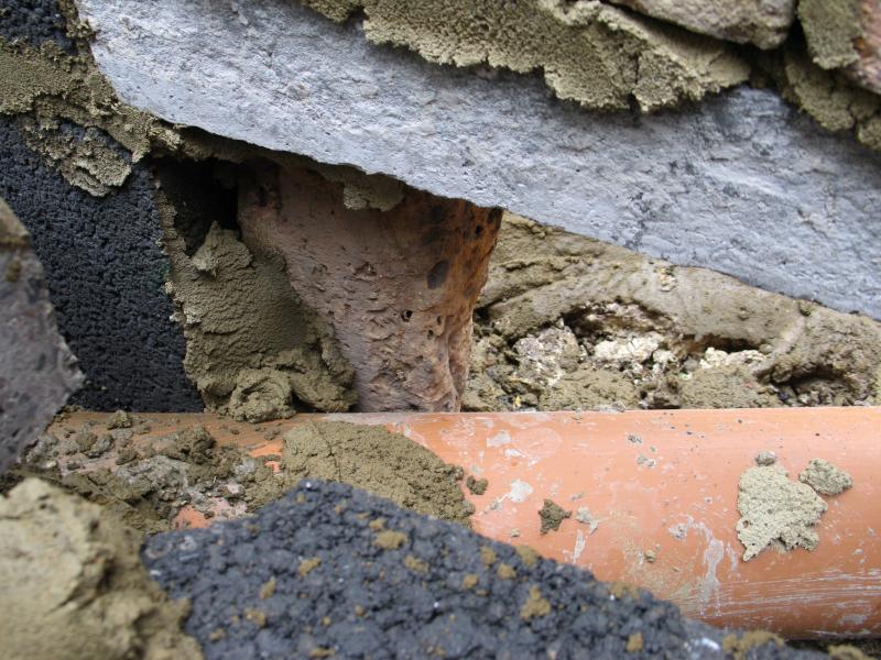

Hi,
I'm having an extension done. At the moment, the oversite work has just started. The brick layer laid a few concrete lintels over the concrete blocks to bridge over a couple drainage pipes. Where the lintel is too short to cover the opening, he put down some old reclaimed face bricks to support it. As these bricks are very soft (birds love pecking them!), I'm not sure if they can support the weight of the wall (single floor extension). I hope I'm just over concious but the thought of the lintel calapsing in the future scares me a bit. Would really appreciate any thoughts there.
1. A corner of the concrete block has been cut to allow room for the drainage pipe and the lintel sits on the remaining part.
2. the lintel sits on a old reclaimed brick which is soft and fragile.
3. Same brick as above but picture taken from the other side. As you can see, the brick is much thinner than the lintel.
4. Lintel sits on a small corner of a concrete block and a brick (can't bee seen easily in the picture) which is much thinner than the lintel.
From what we can see from the photos, the workmanship doesn't look fantastic, but that doesn't mean to say that the thing is going to collapse, particularly as the gap for the pipe is not very wide.
If you are bothered about it, why not phone the Buiding Inspector, put your concerns to him and see if he would come out to check it (they are supposed to check drains anyway). If it needs re-doing, it's perhaps better for you that the builder/bricklayer hears it direct from an official.

Very poor workmanship, even for footings.
Pipe should be bedded on shingle.
Should be 50mm clearance round sides and top of pipe and filled with compressible material with the opening masked both sides with rigid sheet material.
Lintels not long enough and insufficient bearing
Can not see from photos, but rockers each side of pipe passing through cavity wall would not come amiss.

Get the builder to put some 75mm stainless steel expanded metal mesh in the bed joint above the lintel, and then two course above that. Length should be 300mm past the opening on each side so about 1200mm in total

theoldun and masona have both pointed out to you where the workmanship could be better. At the very least, the lintels should be longer. This often happens when the drain passes through the wall at an angle; brickies often mis-judge the width of the gap, which can be quite wide, paticularly when you allow for an adequate bearing of the lintel at each end.
If you look up the manufacturers details on these lintels, you will see that they should have a minimum bearing of 4" to be effective.
As mentioned before, put your concerns to the Inspector, and follow this up with an e-mail to him of the pics. In this way, you are drawing the Council's attention to a potential problem, and they are then more likely to play safe and get the builder to do it properly.
Remember that the Inspector is not a clerk of works or a project manager, and many people have mistaken ideas of what the Inspector can do. However, they have to apply the Regulations 'in so far as they affect health and safety' and I would certainly say that possible faulty support of masonry over a drain could turn out to be a health issue.

Why try and make the best of a poor job? As the job's not too far up, what's wrong with a couple of replacement (longer) lintels?
Because mesh is a viable solution to suit the builder and suit the OP.
It is acknowledged that it is a bad job, so rather than make the situation worse, and generate more bad feeling, if the builder had to alter the walls, it is better to propose a workable solution for both parties

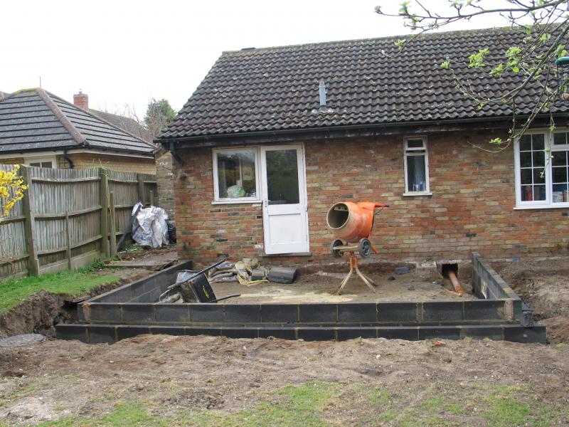

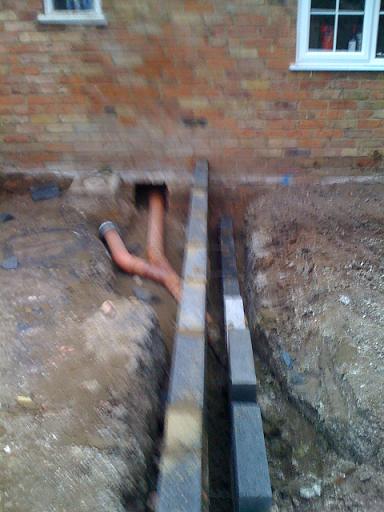

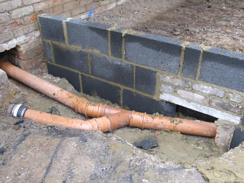

As for the drainage pipes, what is the easiest and most necessary remedy, consider that the pipe has been laid and partly buried? Below are a few pictures which shows the drainage pipe position.
When I spoke to the building inspector last time (on the phone), he's ok with how they are laid. But with all the advise here and my own doubts, I think it's worth getting him to check it on site for reassurance.
1. Drainage pipe - the end to the left is a temporary connection which will be disused and the end to the right is a new connection. This part of the drainage pipe still has a little gap from the ground.
2. Drainage pipe - the part through the wall
2. Overall extension - drainage pipe in the middle left part of the picture

We stand by the above, plus pipes laid in oversite need bedding and surrounding with shingle before sub base unless he is using block and beam.which we doubt as his block work is to high for FFL. Nom 10mm stone is classed as a compressible material. Let BC decide? Have dealt with that outfit out your way before?
