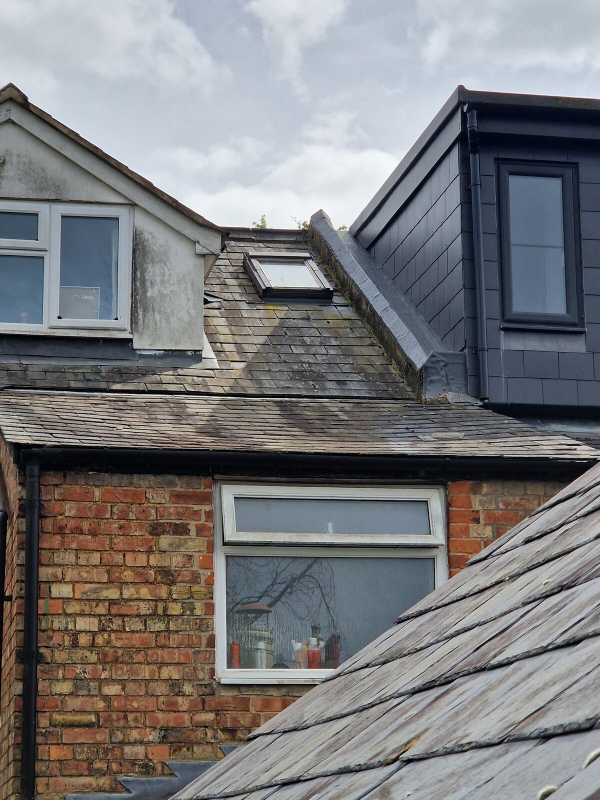

Hi,
I looked out of upstairs bedroom and can see loose tiles on the roof. Do you think these are old?? There are no visible leaks. What should I do, really don't want to have to pay for scaffolding etc just to check!

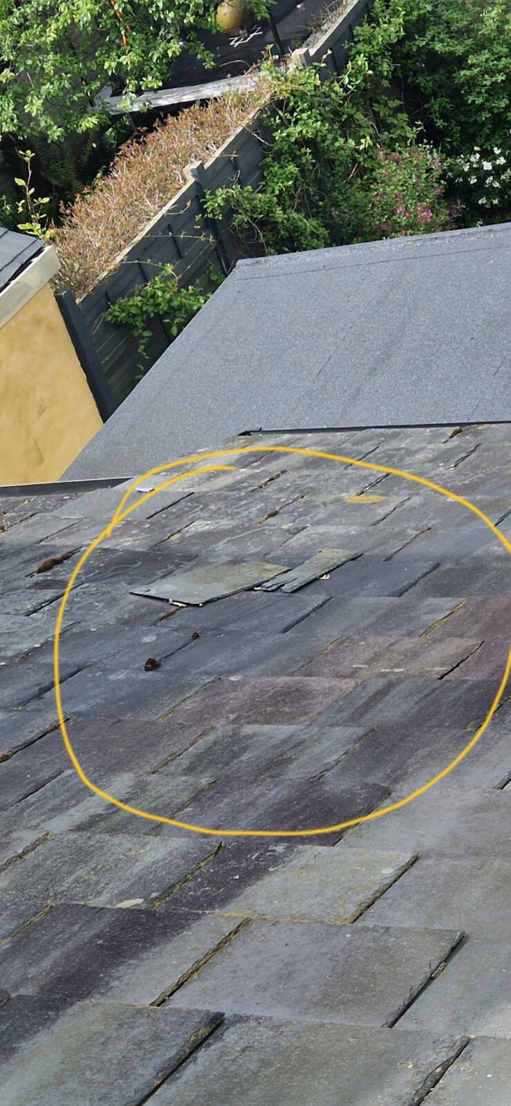

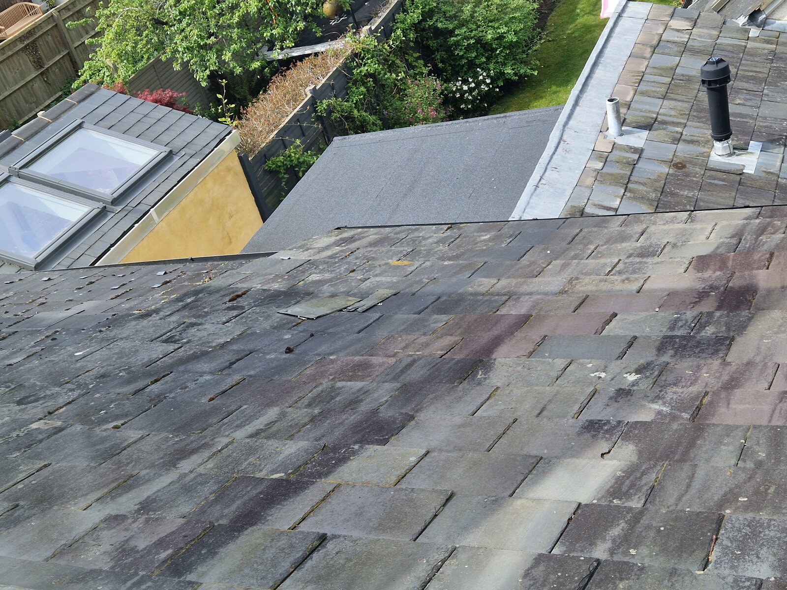

Looks like you have a broken/missing tile from below the bottom right corner of the Velux, plus another probably from up the side of the Velux.
It needs sorting.
The good news is that it can all be repaired via the Velux so no scaffold costs.
