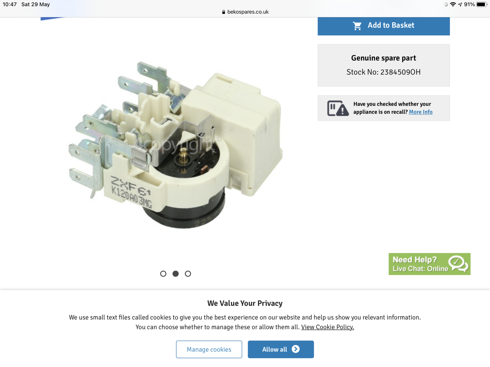

It seems that compressors have two windings, a starter and a running one.I have measured the resistance. 18.3 and 28 ohms respectively. They seem to share a common terminal so you can measure the sum of the resistances. I think on startup BOTH windings are active, then the power to the starter is turned off.
Just turned it on and power consumption was 80w! Wonder if both coils are energised? That’s now dropped off to 38 watts and the compressor seems quiet, but the fan is running and freezer warming up.
I suppose I should be measuring mains voltages, but there is a “ starter” assembly connected onto the compressor pins. I think the power to the starter coil is fed through a positive temp coefficient thermistor. Low resistance when cold, as it warms up because of the current flowing through it, the resistance increases to reduce the power going to the starter coil. There is also a big capacitor, some explanations suggest that this stores energy which is used to kick start the starter winding. I would have not thought there was enough energy stored.
the starter unit houses several components PCR, overload protection and all other components plug into this.
It would be easy to swap out the various bits, control panel, power board and starter. problem is they are not cheap. And I haven’t decided if the compressor has a fault and might be sticking when hot!
I can get the think to start but not keep on cycling properly. I have done tons of research but have not come across a similar issue.
