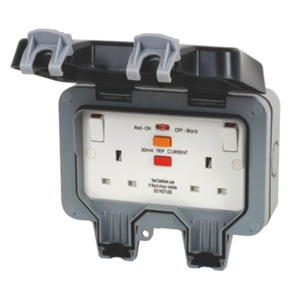

I am after 2 double metal clad style plug sockets, but also wanting at least 3 usb-c sockets too, should I try and find the double sockets with them already built in or try and find a single seize socket with usb-c connections?
You won't be able to get armoured cable into a UK 3 pin plug.
Are you planning to put the metal clad sockets outdoors? They are not waterproof.
How much power will your work area be using and how far is it away from your kitchen - or the nearest power socket?
You probably need something like this > https://www.screwfix.com/p/british-...oof-outdoor-switched-passive-rcd-socket/91095
91095_P
How the power gets to it is another matter but what you're proposing isn't right.

The circuit needs RCD protection so adding a socket with a built in RCD doesn’t make sense imho
Some people might feel that having an active RCD (which is what RCD sockets usually are) is a desirable additional safety feature for outdoor sockets (likely to be used for outdoor tools etc.), even if (as it should be) the circuit is RCD-protected - not because of the RCD functionality but, rather, the 'NVR' functionality (which, to the best of my knowledge, is not, in itself, available built into any BS1363 socket).

but having 2 RCDs in series gives you no idea which one will trip first, and from experience it’s the one at the board
so if the circuit is RCD protected, having a 2nd RCD socket is pointless
