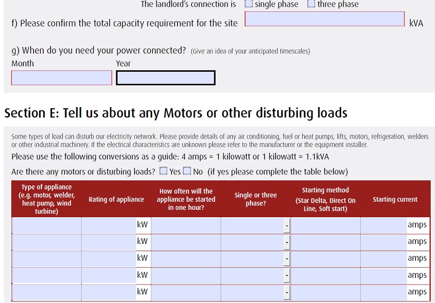

Hi, Planning to run armoured cable from house to garage, what size cable do I need. The garage is only 3metres away form house consumer unit but want 4 sockets for power tools, lights led and welder 180amp working safely any help much appreciated.
Welding set output is normally 25 volt plus 1 volt for every 25 amp so 180 amp at 32 volt so needs around 25 amp the in rush depends on welding set, inverter sets are a lot better, so as @Dan Can says 6 mm² is likely enough, but the volt drop and prospective short circuit current should be calculated first, easy enough to say a 40 amp overload will do, but with a non inverter welder inrush could be a problem, and a type C could be required so loop impedance needs to be less than 0.55 Ω since we have no reading we have no way of knowing if within limits.
For that length may as well Run 10mm it's not going to cost much more. Best go to a wholesaler for it though. At some point a car charger could be installed?
You may need to notify your electricity supplier that you will be using a welder.
This is the application form for a new supply but it highlights the issue with disturbing loads, so called because the inrush current can affect your neighbour's supply.

Basic fact is a welder is not a domestic appliance, but if it does not trip a B16 MCB/RCBO unlikely to cause a problem.
