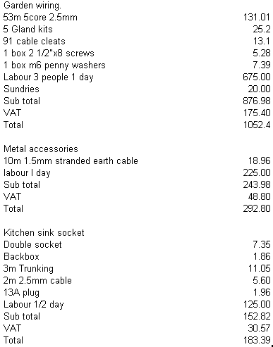

Accompanying the pir was quote to replace armoured cable, fit earth links to C2 accessories and move a C2 kitchen socket:
It seems obvious to the landlord the prices are inflated and his agent has asked for a second opinion.

Outside lights; electrician explained to tennant that the SWA was not allowed to have spurs and the cable was too small and not enough wires. All of the SWA needed to be replaced which meant digging 3 trenches, 2 of which meant cutting into concrete which they'd had laid 2018 and they showed me pictures of the works including what looks like 50mm duct buried deeper than I'd have bothered digging.

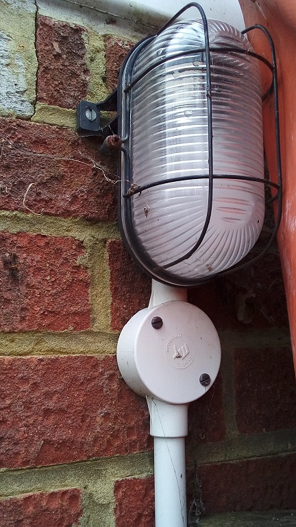

Cables run in shed and garage in 20mm white tube mostly T&E/3C&E.
The original 2W work was nice and tidy but got a bit scruffy with the alterations

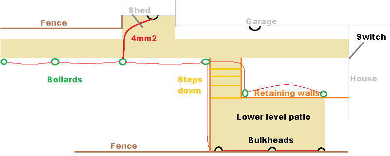

4mm² SWA used to run to the green house at the extreme left of the sketch. The armour without earth connexion at the shed but yellow core and armour linked at the other end in the first Bollard.
Altogether there are 6 Bollards and 3 matching wall lights on fence and 2 bulkheads on shed/garage.
I lifted the covers off some bollards, 2 nearest shed have 3 SWA's each where the 4mm² armour is earthed by yellow wire. I believe wireing layout is as shown in red having seen the pictures during landscaping. Standard of workman ship in the new lights is beautiful using 2C1.5mm², 3 part glands, heatshrink idents.
Althought the wiring in the shed accessories is untidy having been altered over the years, I don't see anything wrong other than no marker sleeves. I'd have preferred to see the armour earthed at the 13A socket.

As it happens total cost of remedials is less than quoted for the earth links.

It certainly didn't require the work quoted for and despite the tennants description of the inspectors proposals I still struggle to understand what he intended doing, especially running along the garage wall when conduit exists inside. 53m of cable/5 gland packs is nowhere near enough to replace all of it and totally flumoxed by 5core.

From the moment I started looking at the garden I actually thought the quote he included may have been for or confused with another job as the quantities just didn't add up.
None of the SWA has shared uses, that's all done in plastic conduit, but he did indicate he would be running cable along the building. which is something I simply cant comprehend in the situation.
