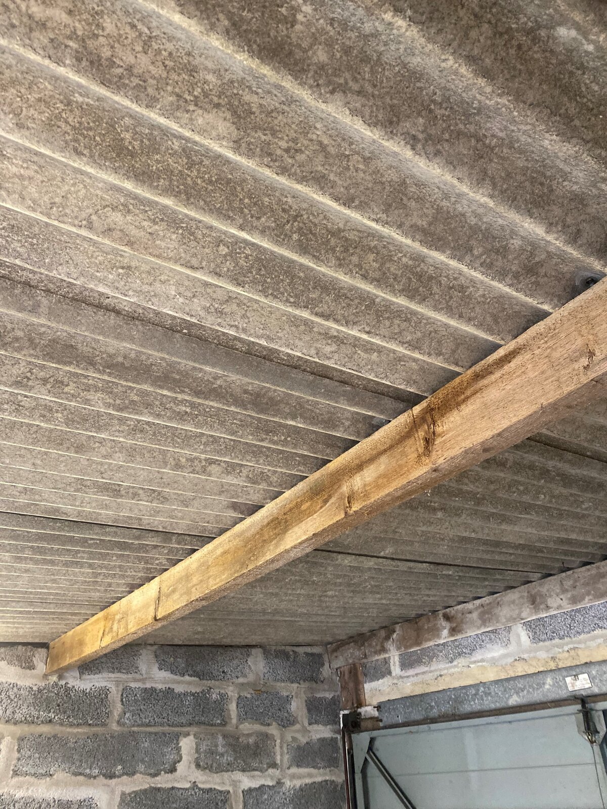

Hi.
We are looking into converting our garage, which currently has an asbestos roof.
Does the roof actually need replacing if it is still in good condition? Also, is there something that can be used to cover the inside of the roof and store insulation?
We were quoted £10,000 for a new flat roof.
Ridiculous cost, for one days work!
If it's in good condition, then the greater risk is in disturbing it, but if you must, then you could DIY using modern box-section galvanised and painted steel sheet, dependant of the size of the garage, for between £500 and £1000. The apparent spacing of the rafters, suggests more, intermediate ones might be prudent.

Can you not just plasterboard the ceiling?

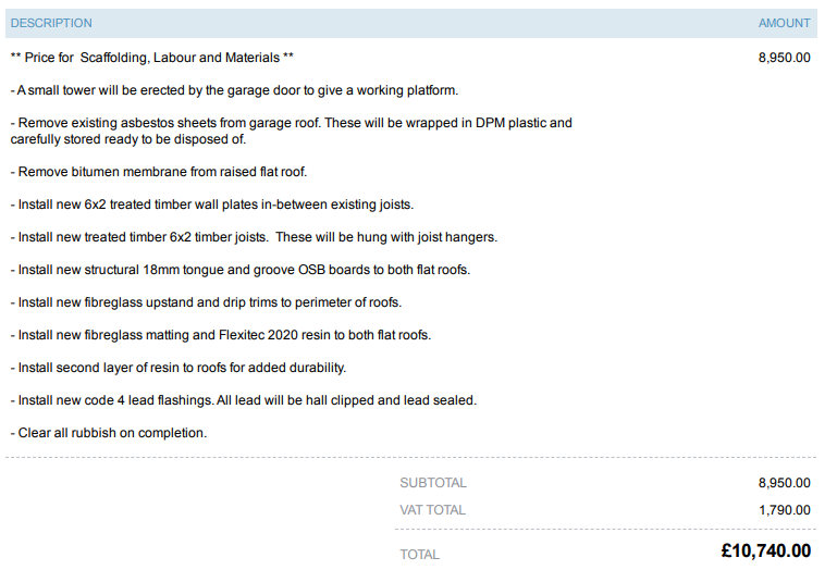

I should say that the quote was for a fibreglass roof, but still a lot, as it is just 6x2.
I was guessing plasterboard would be an option but I'm a DIY novice.

6 by 2? That is tiny, do you mean metres rather than feet?
The fibreglass roof will require OSB or ply. You will need additional supports/joists. Ten grand still sounds expensive. I have only fibre glassed two roofs, but that was back in September 2007- can you post the quote? Someone more knowledgeable than me might be able to advise further.

Thanks. Yes, sorry metres!
Here is the quote.
