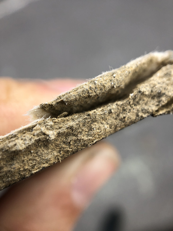

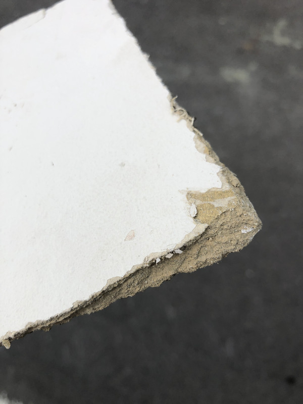

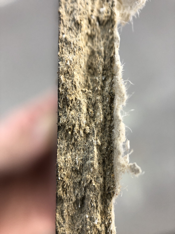

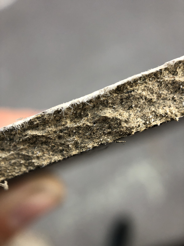

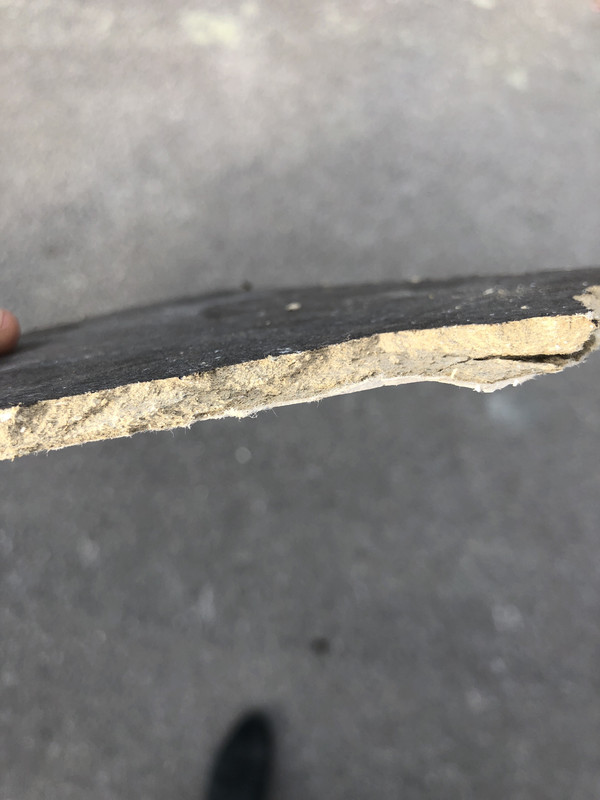

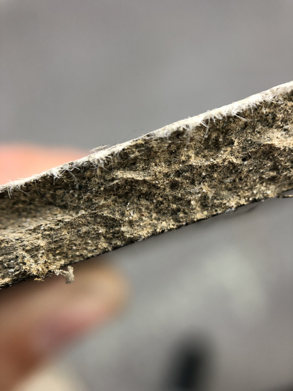

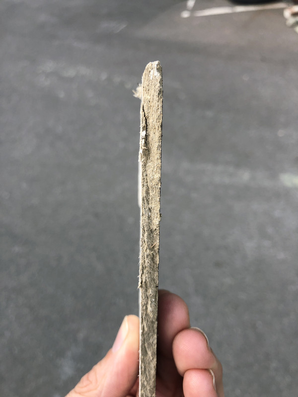

Can anybody help ID this board I have lining the interior walls of my house. Essentially I want to know if I’m dealing with asbestos or not. House is two hundred years old so from an age perspective it could be asbestos based.
It is tough as nails, breaks cleanly (although needing an almighty whack!) and with little dust and no fibrous break off.
Many thanks all!

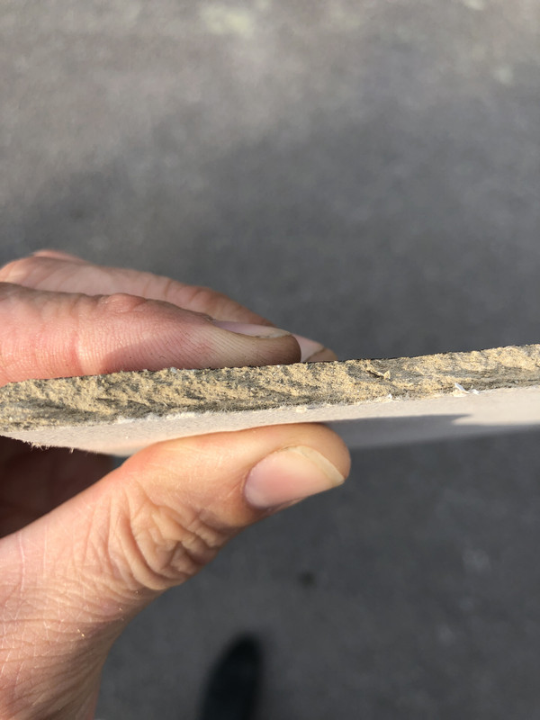

Just noticed the photos are a little misleading, the fibrous broken edges you can see is the wallpaper on the surface, the break of the board itself does not contain visible fibre, it’s pretty grainy.
Just put a macro lens on and snapped a few more...
Get it tested !

I used these guys. They sent me sample bags and once they got them back, test results came in a few days.
Obviously, you don't think it is asbestos, but just checking, just in case (because it's illegal to send known asbestos through the post)

It was double bagged, but I took it there and put in their postbox.

Thanks guys, I’ll get this bit sent off for testing.
Just to be clear... this is the only bit I broke off whilst masked-up, I haven’t smashed the whole house up!
Find a company that tests, follow their rules. Simple as that.
