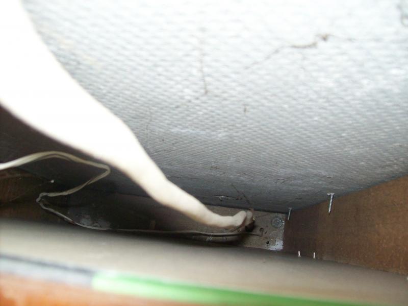

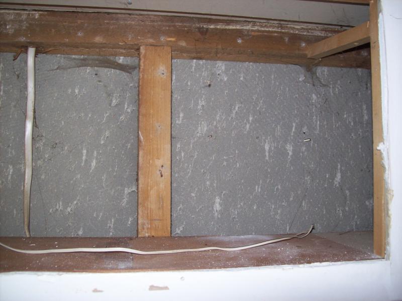

I managed to get into a cavity near the fireplace and take a couple of photos which I've included below. These show the rear of one of the interior walls.
Does anyone know from just looking at it, what this material would be?
Thanks for your help.
Sorry to say so but it looks very much like asbestos AC (asbestos cement) sheeting.
Only good thing is if it is AC that's much less of a concern than AIB (asbestos insulation board) but still a right pain if the whole place is sheathed in it!
Did your survey pick up it was of non standard construction?

The only answer is to get an expert in to sample it. To take one sample and test it will be in the region of £100 plus another £20 or so each additional sample requested to be taken.

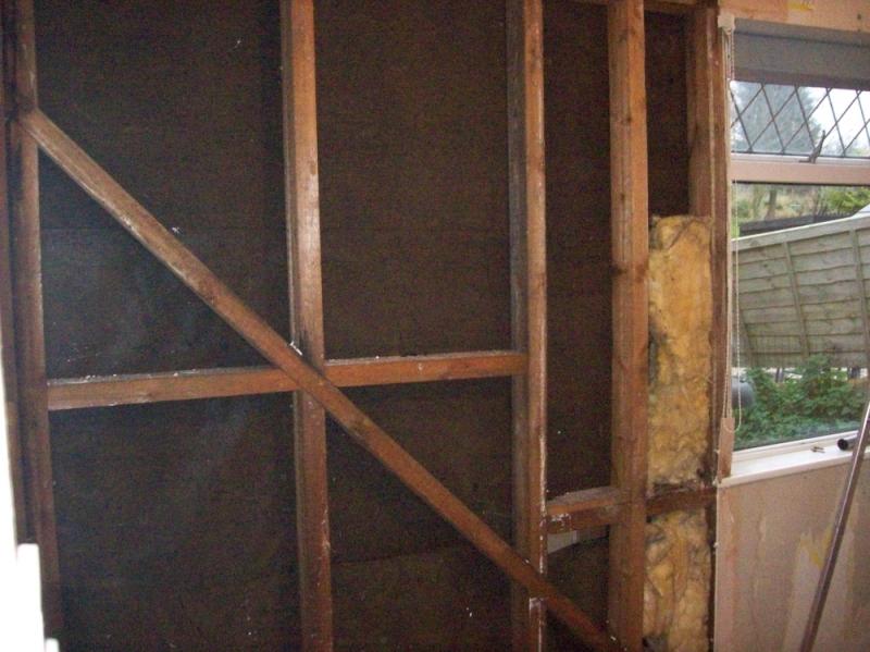

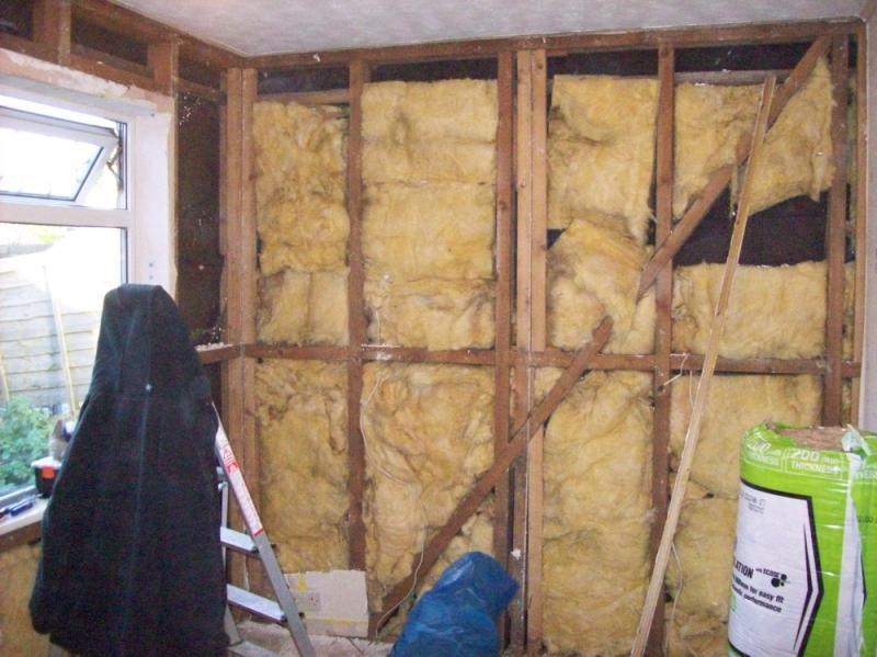

We had to take down some plasterboard in one room that had got damp. I've attached a photo which shows what was behind it. Behind the damp proof sheet is the brick wall skin. I've also shown a photo that is from underneath the floor of the same room.
Does anyone know of any precautions we should take living in a place of this construction? I am assuming one of the main things is to try and keep the frame dry but we are a bit worried that due to it being built in the 1920s, it may not have been designed to last this long. There has been quite a bit of damp around the place that we have been fighting with a combination of ventilation, heating and a dehumidifier. We love the place and want to stay here for many years, so we want to try and stop it from collapsing!
The dampness in those walls is due to condensation. Include a vapour barrier between the insulation and new plasterboard. 1000g polythene will do it with taped joints and sealed edges.
