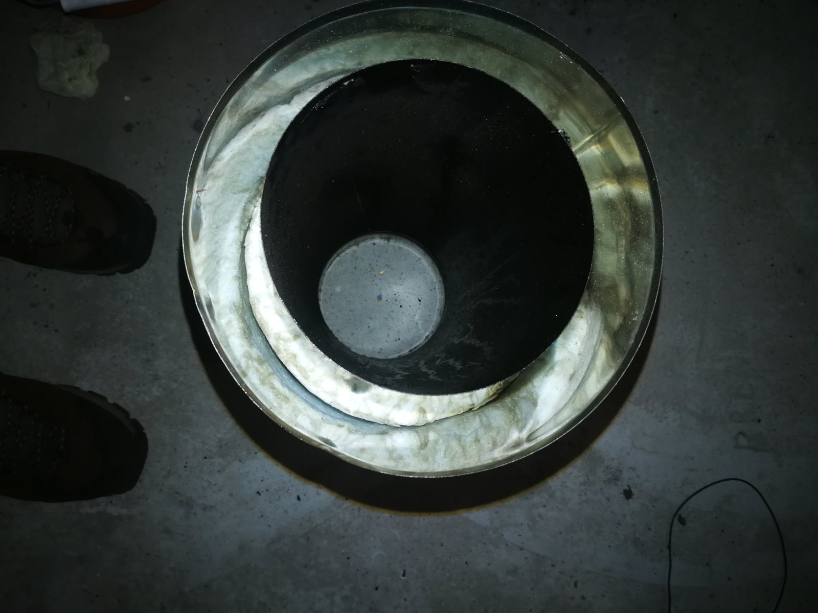

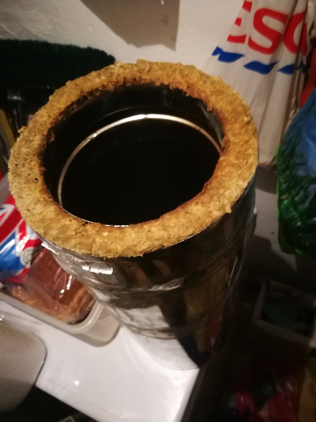

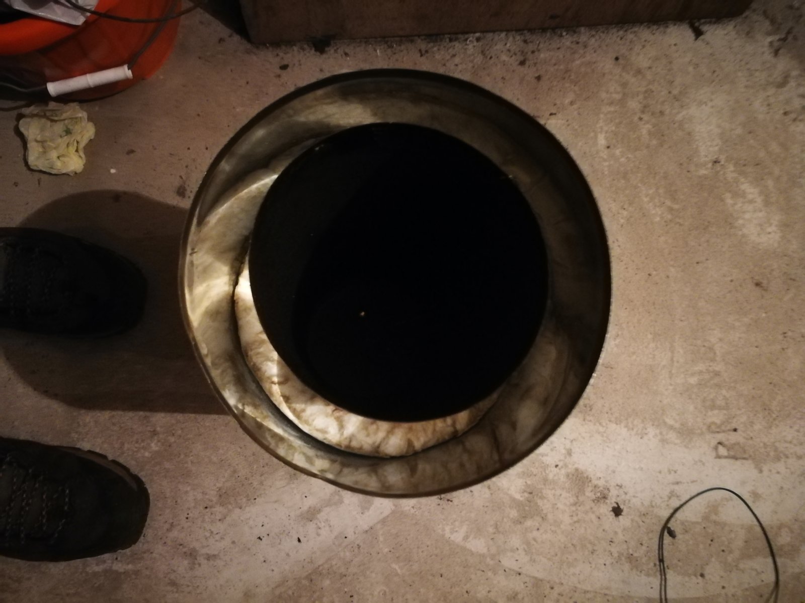

Hi folks. Can any one offer some help /reassurance? The aluminium flue (pictured) contains some yellowy material that looks like rockwool but the other piece has white stuff which I'm a bit worried about. Please have a look and tell me what you think. Many thanks.

Can you post pics of the full lengths ? The yellow one would have been white originally but flue gasses have been leaking into it. Is it off an adjustable length
Hi mate. I'm not sure. I can get more pics of it tomorrow and post again. Panicking a bit.
Insulation is usually glass fibre type and not harmful , unless you eat it .
No worries. This is second hand flue. Shiny aluminium and looks modern but the stuff within the twin wall I'm not so sure about
Are there any brand marks on it, I know Selkirk has never used asbestos. Is this a flue youve taken down or bought second hand to reuse?
