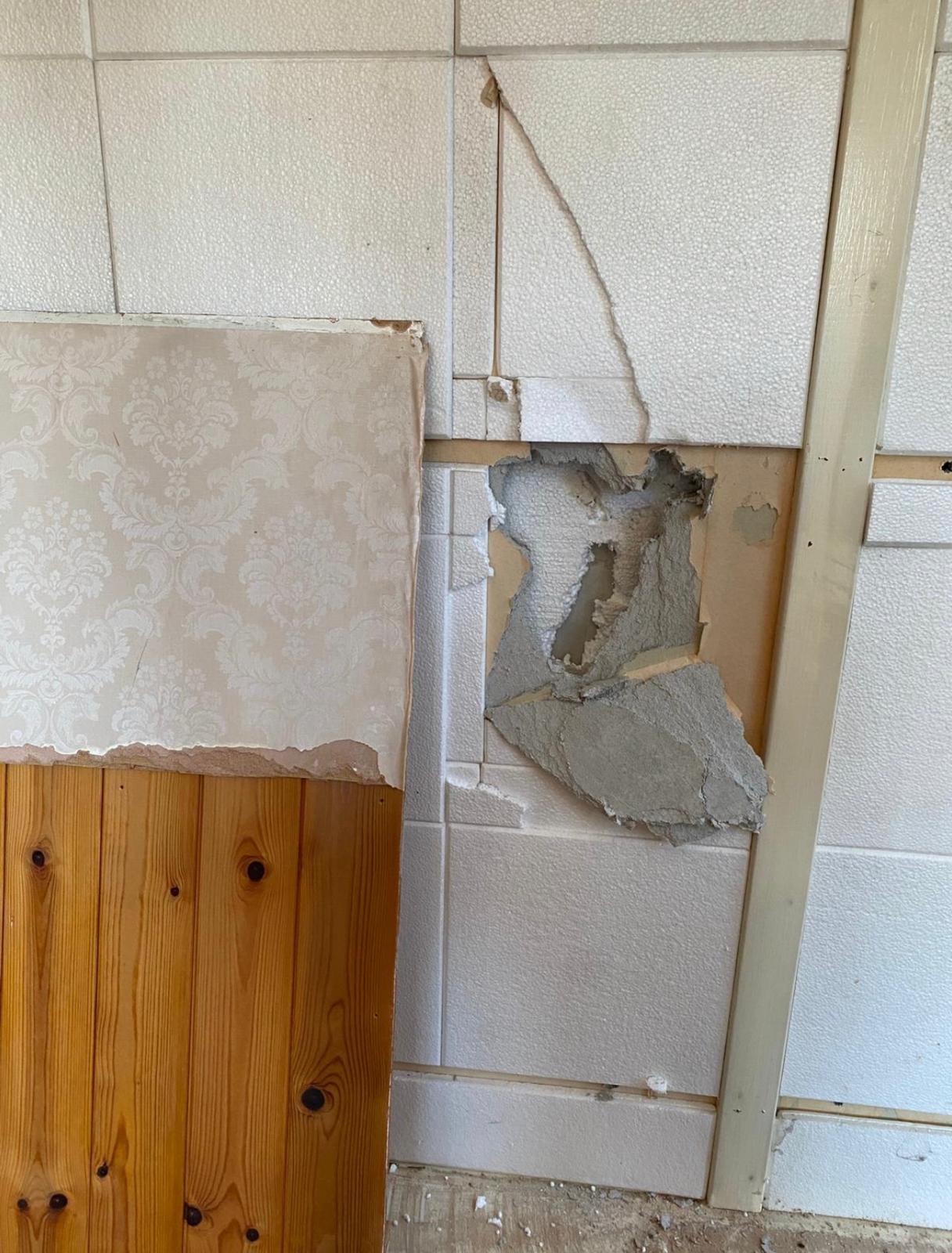

Recently removed what I thought was (gypsum?) plasterboard (AIB found on external wall was different - seen in grey panels)
just wondered if anyone had insight to potential asbestos, unfortunately I can’t have it tested as it went in the skip!
It is the board below the window internally and along the back wall (screwed on to the brick). It was wallpapered. I believe it was added later than the original structure.
house built 1961. Conservatory added potentially 1980? and modifications such as extra glass windows to double glaze and additional polystyrene at a later date 1990/2000+? Fibreglass in ceiling cavity.
the radiator was hung on the back wall under window - fitted to this board.

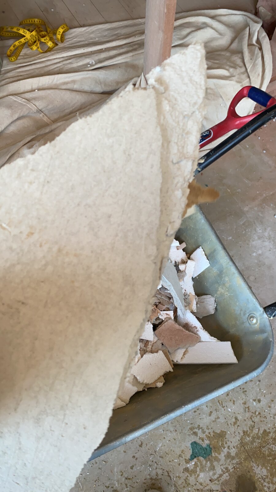

It's difficult to say from an image, it could be AIB or fibreboard. Often it's possible to give a good guess between the two by feeling it or by soaking or burning.

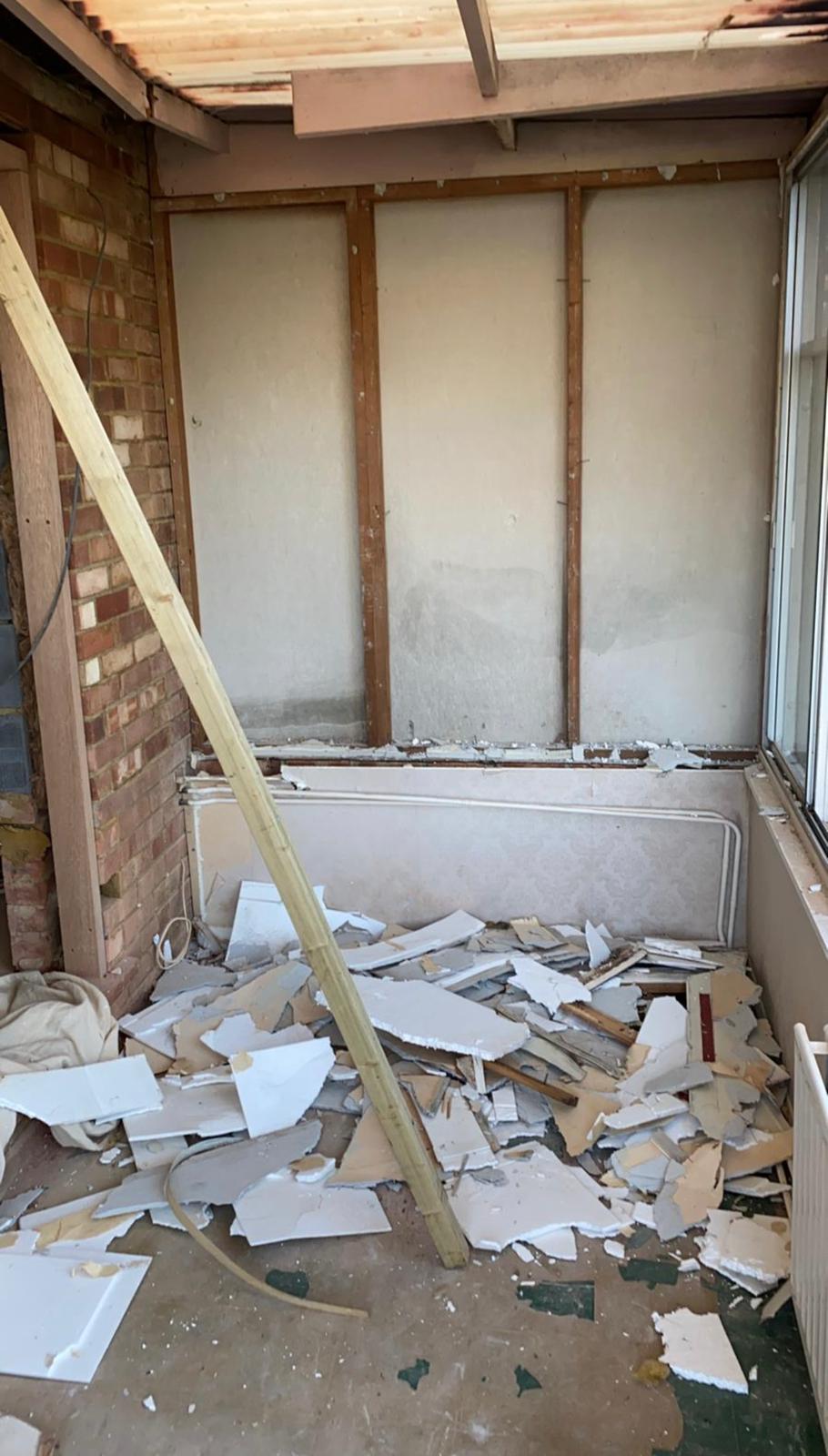

For what it’s worth,
the top internal board is plasterboard right? Boards on floor after pulling off.
There’s been so many additions to this structure
