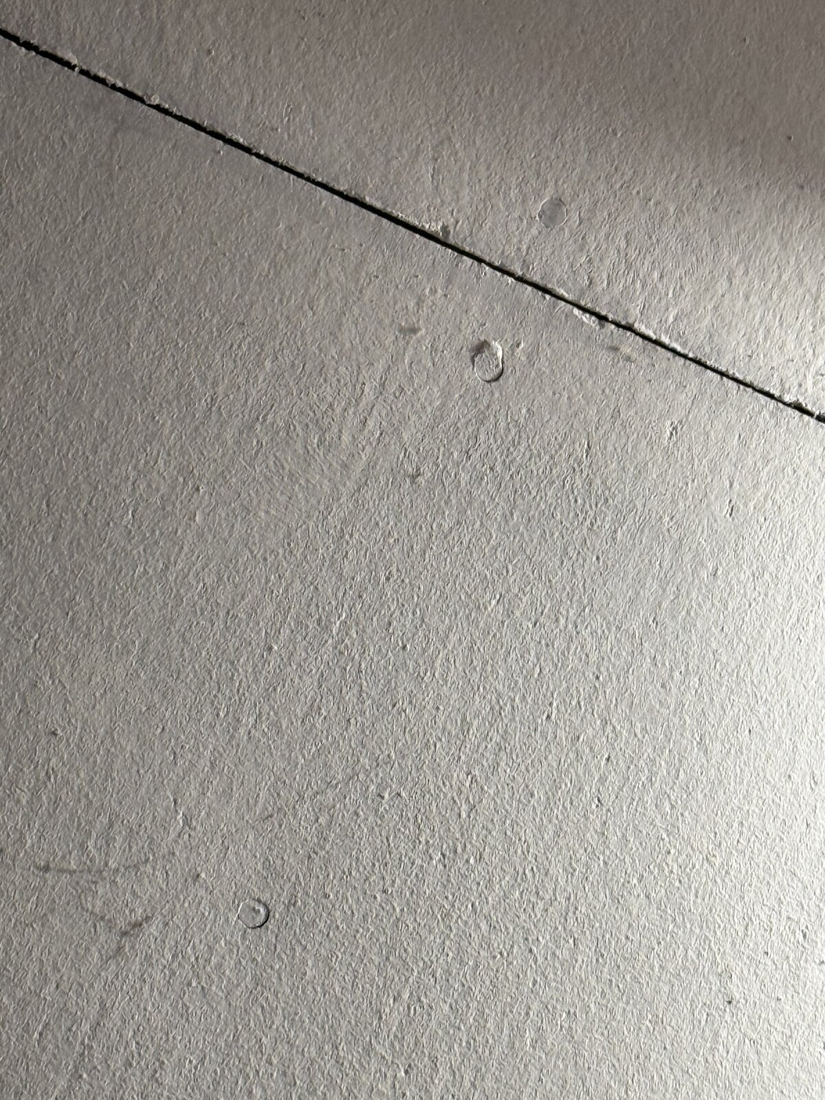

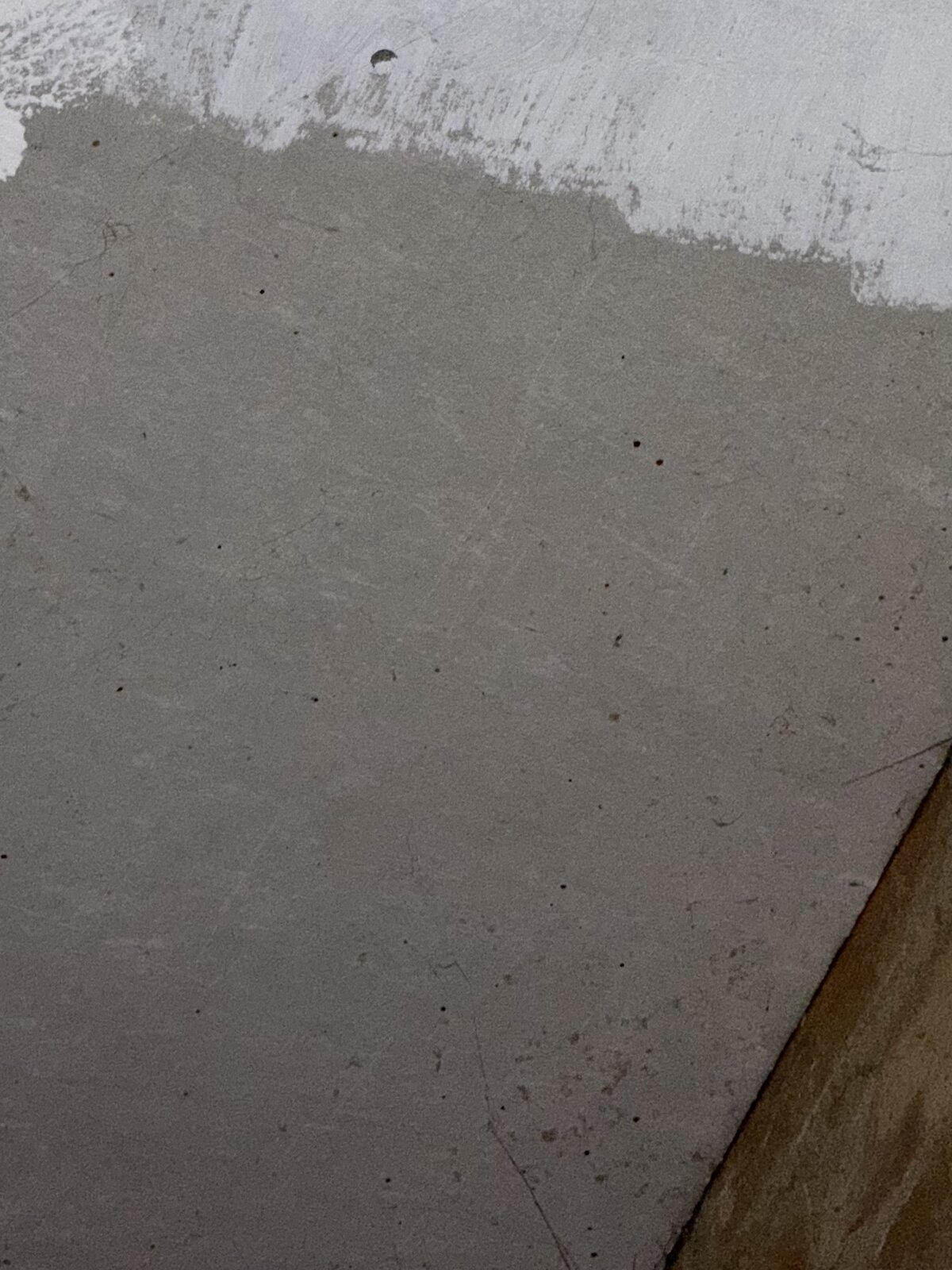

Some pictures attached. Most of it has a light coat of paint already that was already on when we moved in.
I’d just feel happier with a much thicker coat of paint over it.

Presuming it is in decent condition and not being affected by damp or water ingress, just paint it.
I wouldn't recommend fixing anything to it: not only would that likely create a hazard in the doing, it will also be more likely to fail later on - causing even more hazard, and expense to put right - and make its eventual planned removal even more troublesome and expensive.
Task guidance sheet A7 for the specifics.
Thanks very much. That’s really helpful. The painting option feels like the most sensible thing to do until we can afford something more permanent.
Cheers!
Definitely wouldn't glue anything to that. As others have mentioned, you risk ripping it off the nails. Painting is a definite option and use the HSE guidance on how to do this. From those images it looks to be in good condition.
