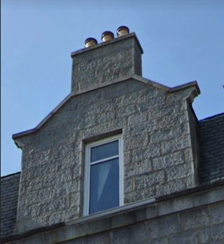

Hi! I've got a leak in my tenement (third floor, so pretty high up) building in Scotland, and two experienced roofers are in disagreement about where the leak is and in disagreement about the best course of action. I'd love some input from people here if you have time!

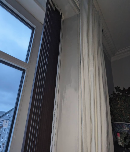

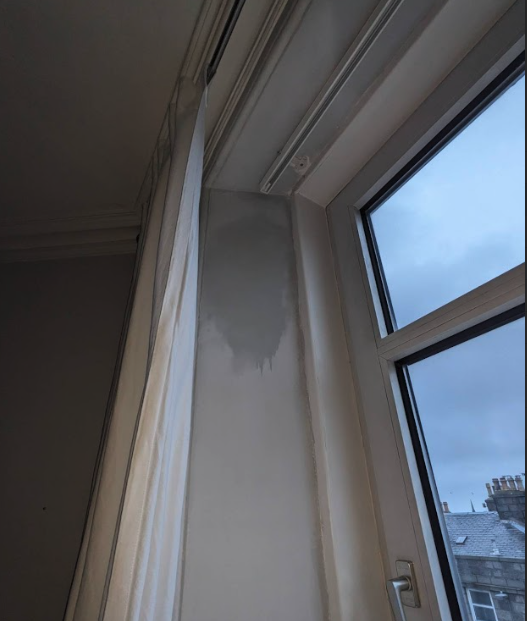

After the recent spells of rain we've had, the plaster around the window shown in the image has started to become damp/wet. Damp areas are shown in the images attached at the sides of the top of the window. Wet areas are also present on each side at the bottom of the window, on each side of our window sill.

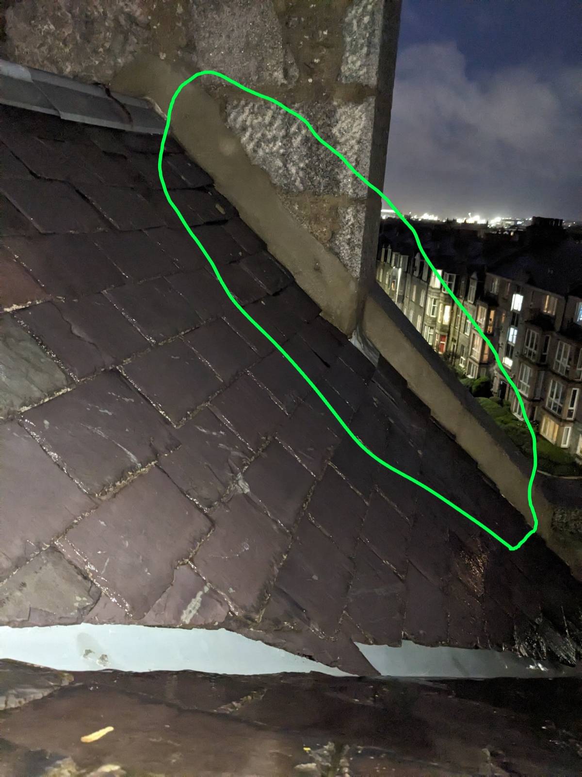

The first roofer to come round was an old chap who popped his head out of the window and took one look at the cement/mortar highlighted in green in the images and said it's your skews. He said the cement hadn't bonded to the slates, and you could see that the bottom of the cement nearest the slates was darker than the rest of it, therefore it was letting water in. He said this needed broken out and redone. There was a similar issue on a second chimney breast, so he quoted for two scaffold towers (third floor) and also said the chimney pots were ready to come down so he'd also recommend these get replaced.

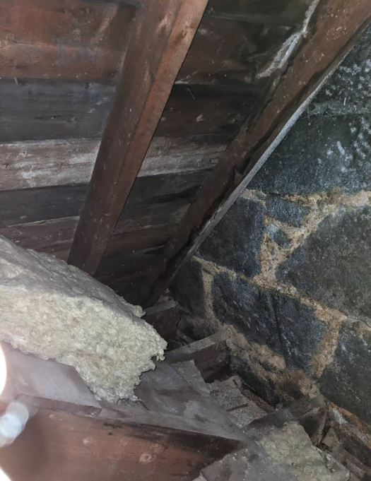

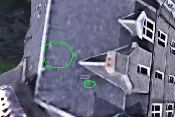

Roofer #2 came round and said it wasn't the cement/skews - he said the slate was pushed up tight against the brickwork so water wouldn't be getting in there. He also took a look further back up the roof and said there were tiles missing higher up the roof (I've highlighted the large green circle in the aerial/top down photo) and that was likely the cause as it would stream down the roof to the window. I tried to get a look inside the piece of roof above the window though it was quite difficult to access - there's a pic attached of the bit above the right side of the window and looks possible that there's a wet patch on the corner beam, so that would add up with what he's saying.

So water is appearing at the top corners of a dormer window, that is part of a wall that has chimneys running up either side of it?
And one roofer is claiming that missing slates on a different roof slope that doesn't have felt fitted, is the cause? Wouldn't be my first guess..

It's not a different roof slope - it's directly up from the window so any water coming in via the missing slates up there would be running down to the window. The picture from inside the loft shows the bit of roof that's directly above the window, and down from the missing slates.

The chimney head has open joints as can be seen in the pictures.
The mortar around the chimney does not look old ?
I'd guess soakers are zinc and corroded . These are likely in need of replacement to the parapet and chimney a decent flashing would help too .. and if anyone says it can't be done ..it can.

Thanks! Yes the mortar to me looks new as well. So the chimney head joints you mention that are open - is that the bits I've highlighted in the pic (called skews by roofer)?
If so, the second roofer said that's not the issue as the slates were pushed up flush against the brickwork so there's enough overlap there to stop any water. Other roofer didn't agree with that though.
Water proofing has nothing to do with pushing the skates tight.
The soakers should deal with that .
I would expect the soakers to have corroded . This can only be checked by removing them .

Must be something wrong with my eyes then cos pic#3, taken from google earth, has green marks on the main part of the roof (the roof that would still exist if the dormers were removed). Water ain't gonna start in that green circle, roll down the roof til it hits a broken slate, then crawl sideways along the underside and all the way along the dormer slope until it can run down the wall with the window in it
So just going with the logic of what my roofer said - if there's water getting under slates at the green zone I highlighted, that could be running straight down a beam (or multiple beams) and to the dormer. The pic I've shown from inside the loft shows one such beam which follows that line and ends just above the right or the dormer (beam also looks wet at the top). Not saying he's right but just trying to explain the logic and it seems plausible to me.

Roofer 1 is correct by a country mile...No soakers on those skews. Its a Scottish thing.
