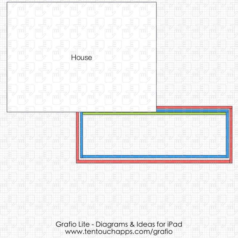

We have an outhouse attached to our home with a concrete roof and single skin walls. I am planning on knocking this down and rebuilding with a slight extension and a lean to roof with the roof batten (for the rafters to sit on) being attached to the outside of the house, as you'd expect.
However I want to extend beyond the end of our house into our garden, with the exterior house wall (with the batten attached) forming the inner most wall of the new extension. Ideally I would like to have a double skin wall (block and brick) on the new walls I build for the extension, however, the batten will have to extend beyond the wall of the house, alongside the new wall to be the full length of the extension. If I want to double skin, this means that the roof batten would have to attach to the interior skin of the new interior wall to line up with the exterior house wall.
I hope the above makes sense - I can't supply a diagram from my tablet.
If anyone understands the above, Is this appropriate (within regs)? I can attach ridge tiles where the top row of slates meets to top of the new wall, so I'm not worried about water ingress as such, but am happy to be told otherwise.

Edit. For batten, I mean ridgeplate I think - sorry for my terminology.
