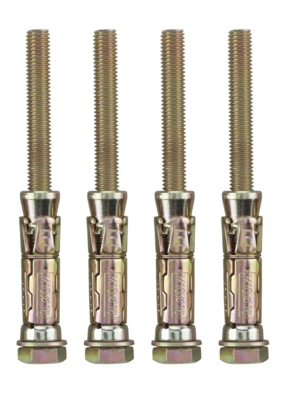

I'm building my own pergola, basically its going to be against our house on a patio area. the design i'm going with is two posts, with a support beam at the front - the rafters will then sit on top of this and on top of a ledger attached to the house at the back end.
My question is - what is going to be the best way to attach the ledger to the house. Its a brick built house and i'm planning to attach the timber ledger straight to the brick - what fixing would be best - screw and rawl plug or some other means?

Anchor bolts;
0000005041381_001c_v001_zp
they come in various sizes from a well known shed.
The thick end goes into a hole in the wall so that the threaded bolt is protruding. Drill hole in your timber and fit bolt through it, then as you tighten the nut (not shown in pic and you use a large washer on front of timber) the part in the wall gets expanded and fixes it firmly in the brick work.
The packets instructions will tell you what size hole is required in the brick work.
Use some stainless washers between brick and timber too - to pack the ledger out by 10mm or so - allows mositure to run down wall or off flooring edge.
