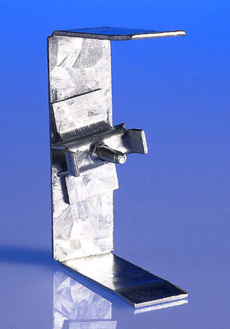

What's the best way of fixing metal clad boxes together?
I've thought a 20mm galvanised coupler with a brass bush inside each socket. This will mount them nice and straight and also allow cables to be passed across from one to the other.
Ideally I'd like them closer together than the length of a coupler, but I can't think of another way?
Use a long bush with a lock ring between boxes and a lock ring inside the box, this will allow close coupling and allow the faceplate to go on
https://www.tlc-direct.co.uk/Products/AP604.html
joins two boxes together with correct spacing for standard size seitches&sockets
Ahh. You are quite right

You could saw your 20mm coupler in half and make two 9.5mm ones (1mm lost in sawcut).
That could also move the switch fascias too close to each other, go with the default distance.
