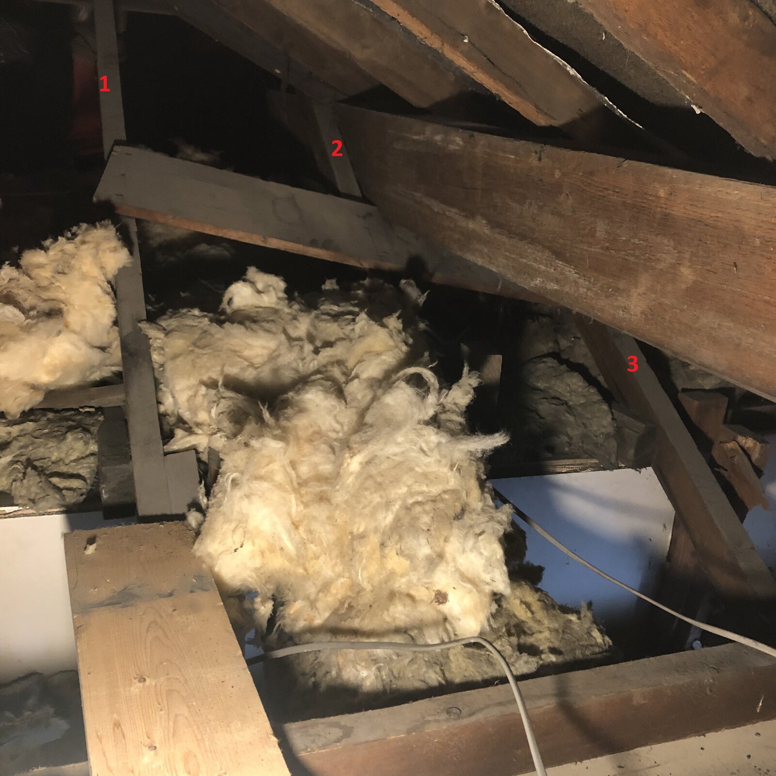

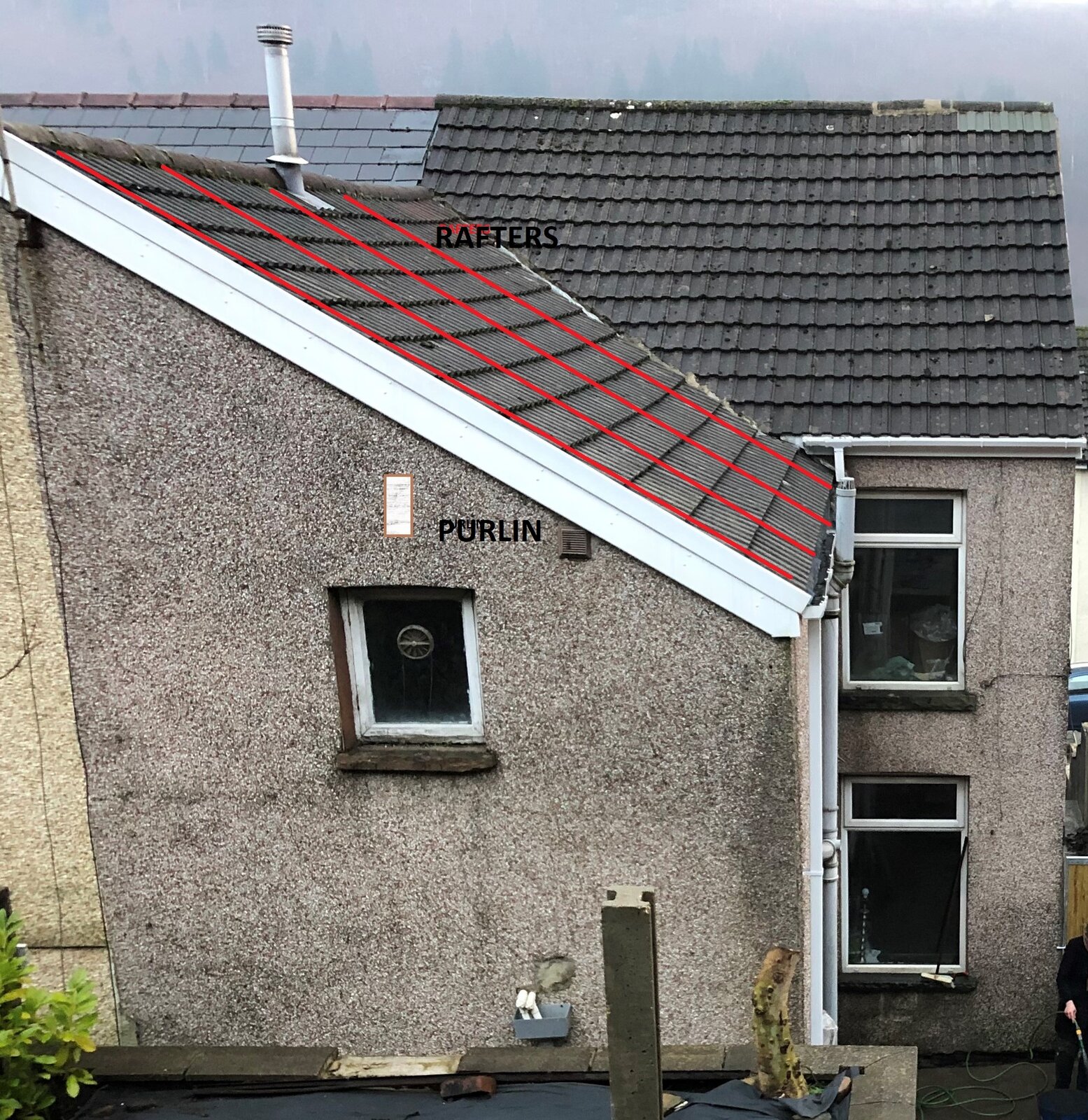

We have recently purchased an old house with thick (45cm thick ) solid stone walls.
The main structure of the house is as you can see in the photo. My question is in regards to the extension roof structure.
There is a purlin (3" x 8" i believe) going from the solid wall all the way to the valley. The purlin is inside the solid wall on one end but on the other end (by the valley ) the only support it has is a piece of timber attached to 3 other rafters from the main (double pitch roof /photo attached)
I understand these houses had originally slate roof tiles which were commonly replaced by heavier concrete ones in the 70s & 80s and as you can see this caused a bit of a sag in the extension roof.
Now my first question is ,is this support enough for the purlin on either end ?
If not what can i do to fix it ?

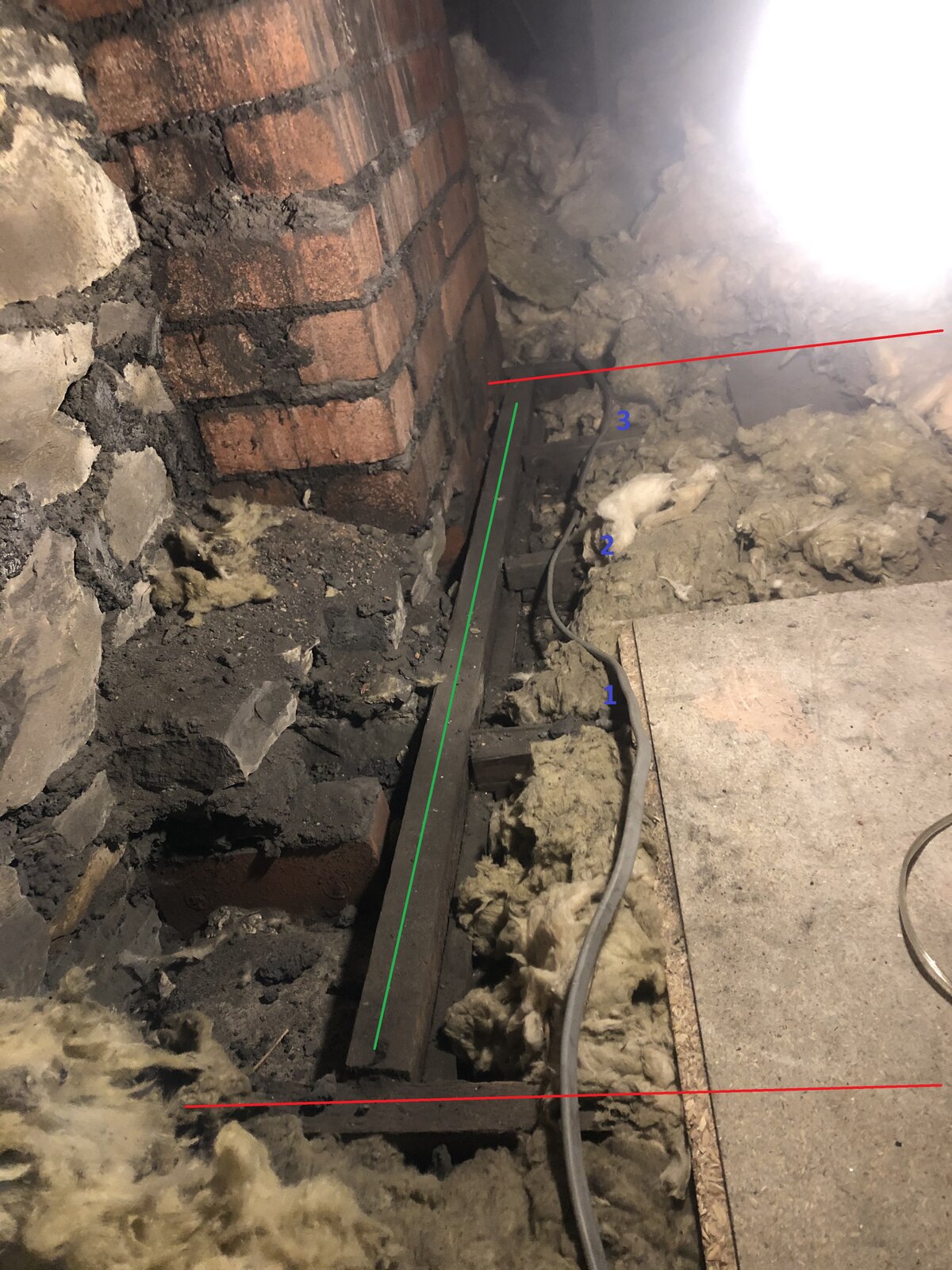

Now the 2nd issue i have is about the joists halfway along the purlin and the purlin itself.
For some reason ,it looks like 3 of the ceiling joists were cut and joined into a piece of timber that is then joint to 2 joists going in to the wall after the cut joists number 1 & 3 .

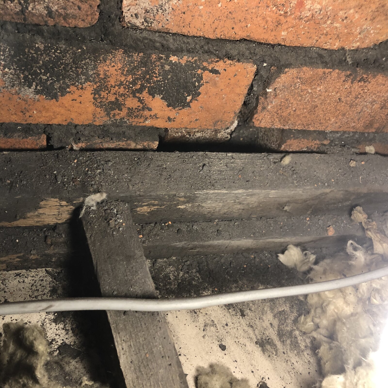

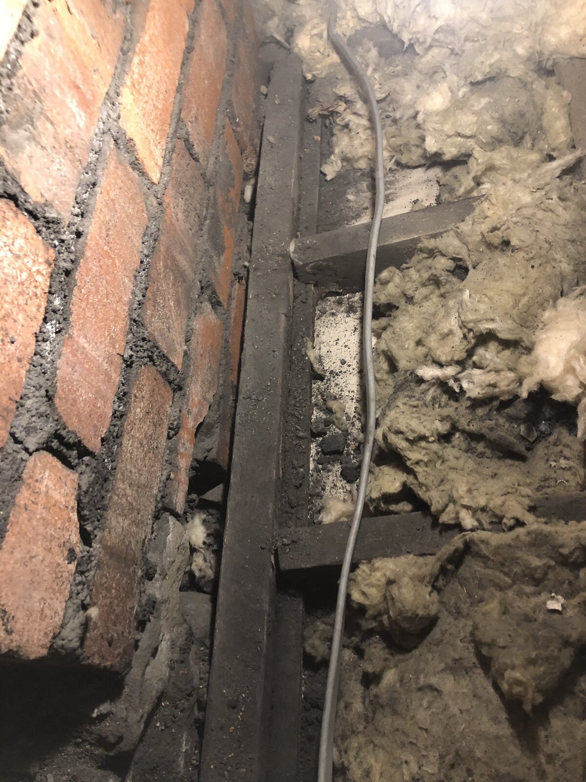

Also as you can see there is the chimney breast to the left of the cut ?! joists .
Some closer shots here

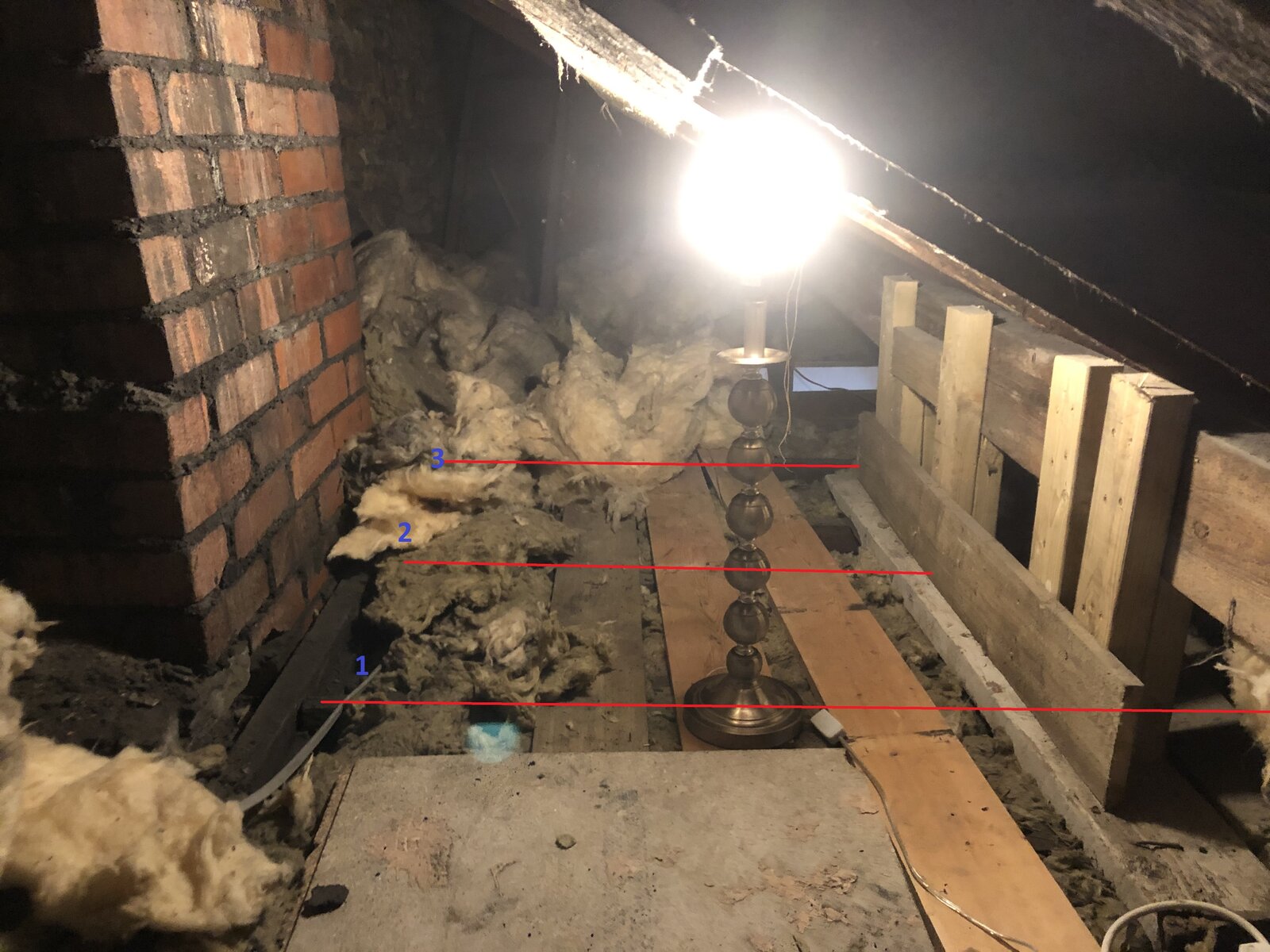

Now to add to the misery , the purlin along this part has sagged which i am assuming is due to heavier tiles and the length of the purlin itself (around 25-30 ft) and where it sagged there is a timber jacking structure that i believe is built at some point to support the sagged purlin from underneath.
By the way the joists here are joined to the roof rafters at the other end , which are resting on solid wall.
here is a photo of the purlin showing the sag
Surely ,It cant be right having the weight on 3 joists being passed on to 2 other joists which already have weight on them.
So my 2nd question is ;

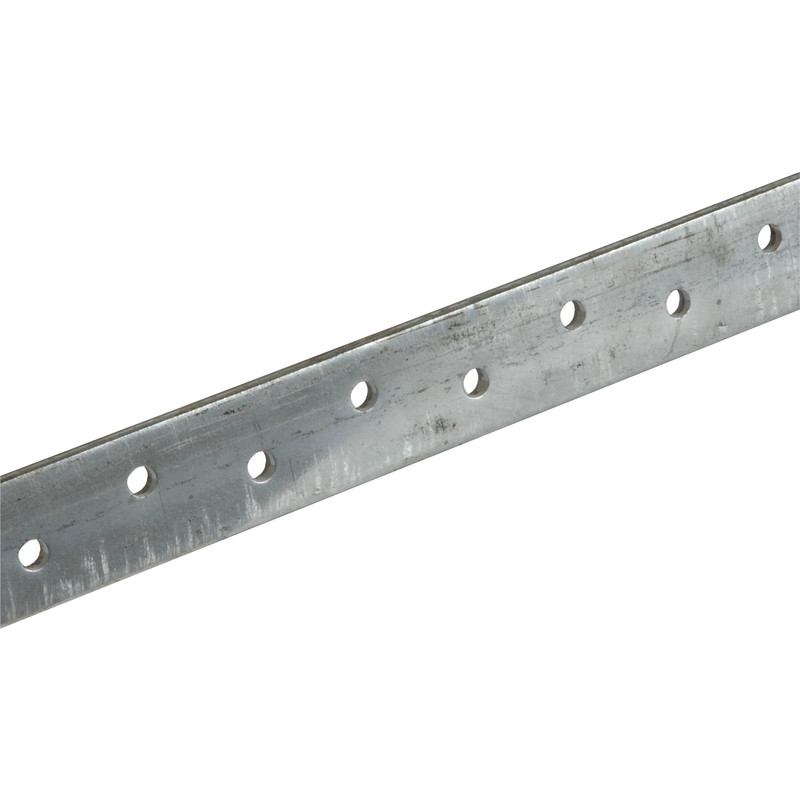

How can I resolve the issue with the 3 cut joists ? Is there a way to sister some timber to them using strong metal strap and thick bolt and nut setup to pass the weight of these 3 joists back into the solid wall / chimney breast ?
Many thanks in advance for reading this .
