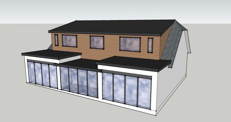

I am planning an extension and roof adaptation. The extension will have 3no. flat roofs at different levells and the roof will have 2no. shallow pitched dormas
The question is, grand designs alway use all sorts of different roofing materials from rubber roofs to zinc/copper sheeting etc but cant seem to find any on the net now they are of interest. Anyone any suggestions?

Thanks for that. It isnt a flat roof at 1st floor level but a shallow pitch, around 14 deg. I didnt want to tile is and i wanted to keep it light, see pic below. The steeper sections either side will be tiled

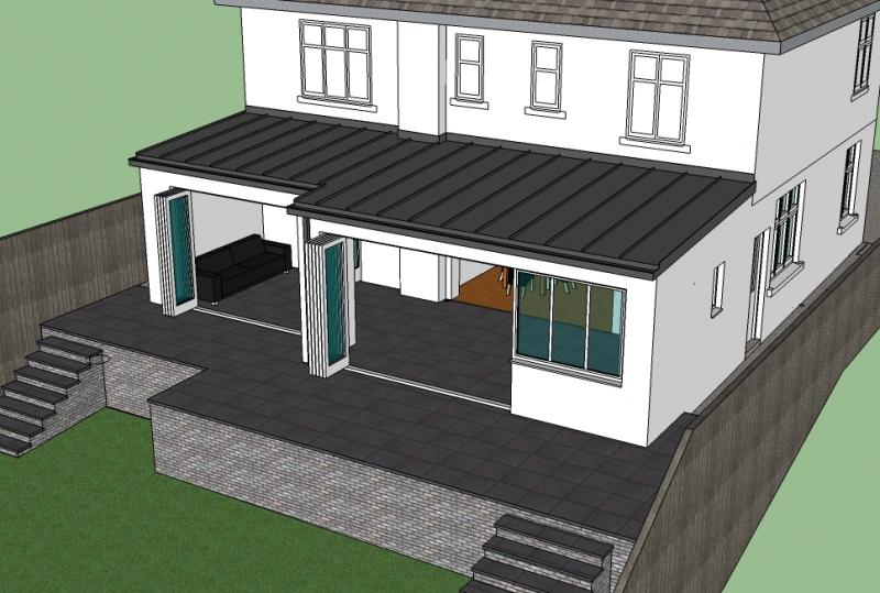

Zinc is your friend, BTW you'll need SAP calcs and a structural engineer for all that glazing! I did a similar design a while back for a client.
Got about 3/4 way through the regs drawings when he pulled the job when he found his bank wouldn't increase his mortgage! :rolleyes:

You can see them everytime you look out the windows though and its not just the roof top but the verge/gutters/downpipes etc that go with a metal roof. My client had all this in mind through the design process he was pretty clear that he thought the usual suspects (felt, edpm etc etc can look cheap. Each to their own.
