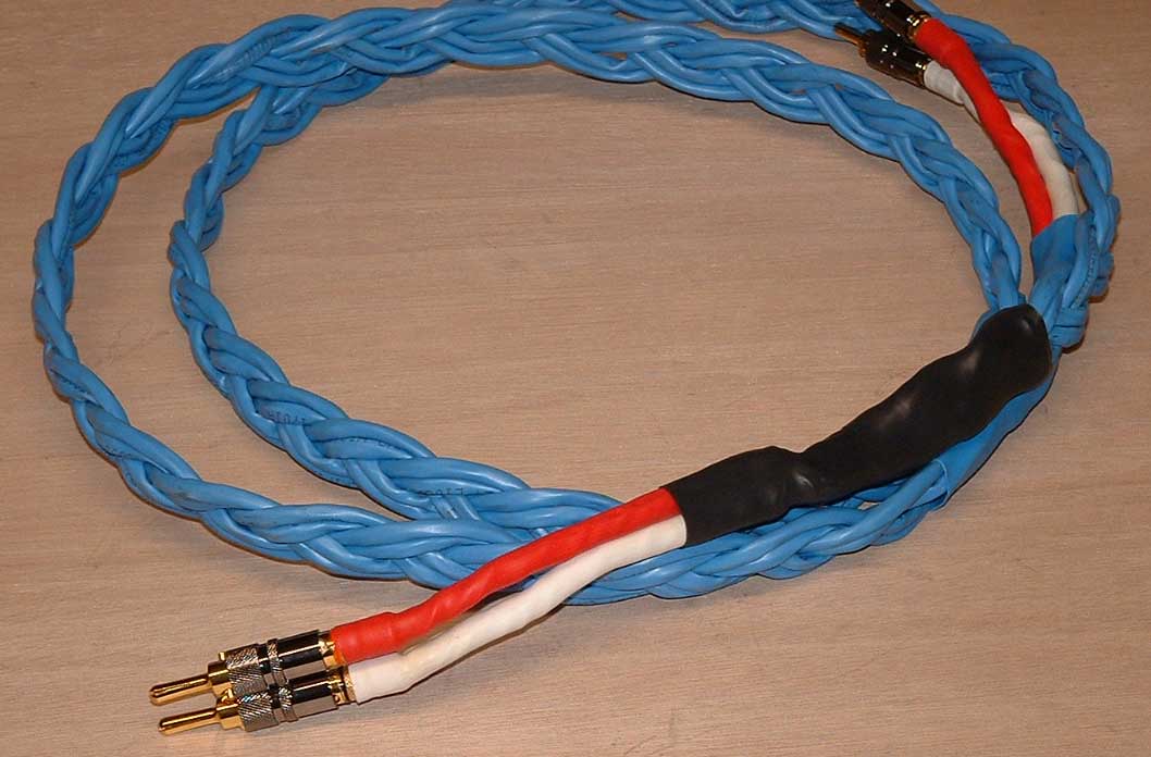

4. I have been told that as CAT6 cable is high quility, it can be used as a cheap alternative to the more expensive proper speaker cable. If you keep all the solid strands as + and stripped as - you will get better noise reduction. Does anyone have experience of this?
I don't think I want to goto this trouble for the interconnects though: :)

4 - Again, speaker cable is best for speaker signals in my opinion! And it again depends on how centralised your "Node Zero" is. Will all your amplification be centralised too? Or will you be using active speakers, in which case you are distributing line level, not speaker level!

I'd use 79 strand contract speaker cable which at £40 for 100m is £160 cheaper than some speaker cable makers (QED) 79 strand and is all but the same stuff.
