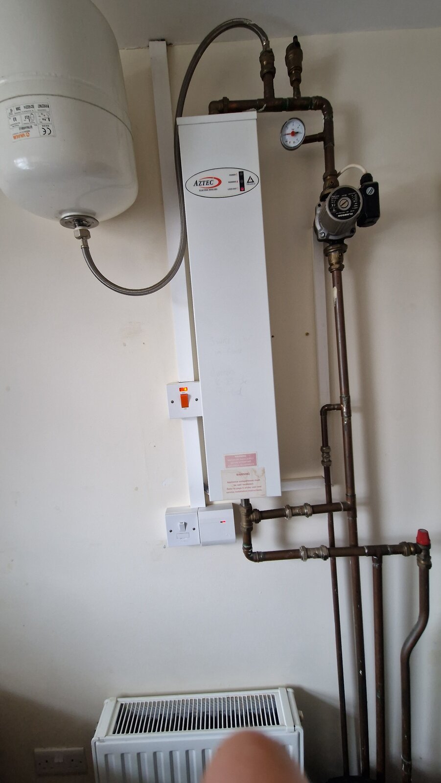

We have a aztec electric boiler.
It was working but not has a constant red light showing lock out.
I've tried resetting it by turning it off and on. But won't work.
Any ideas would be amazing!
From the instructions (attached), it appears as if the 'high limit thermostat' may have operated...
As in the instructions, you can try resetting the thermostat, by pressing the red button in the middle of it.
However, there was probably an issue to cause the thermostat to trip in the first place. If it trips again in a short space of time, turn the boiler off - this will need further investigation...
