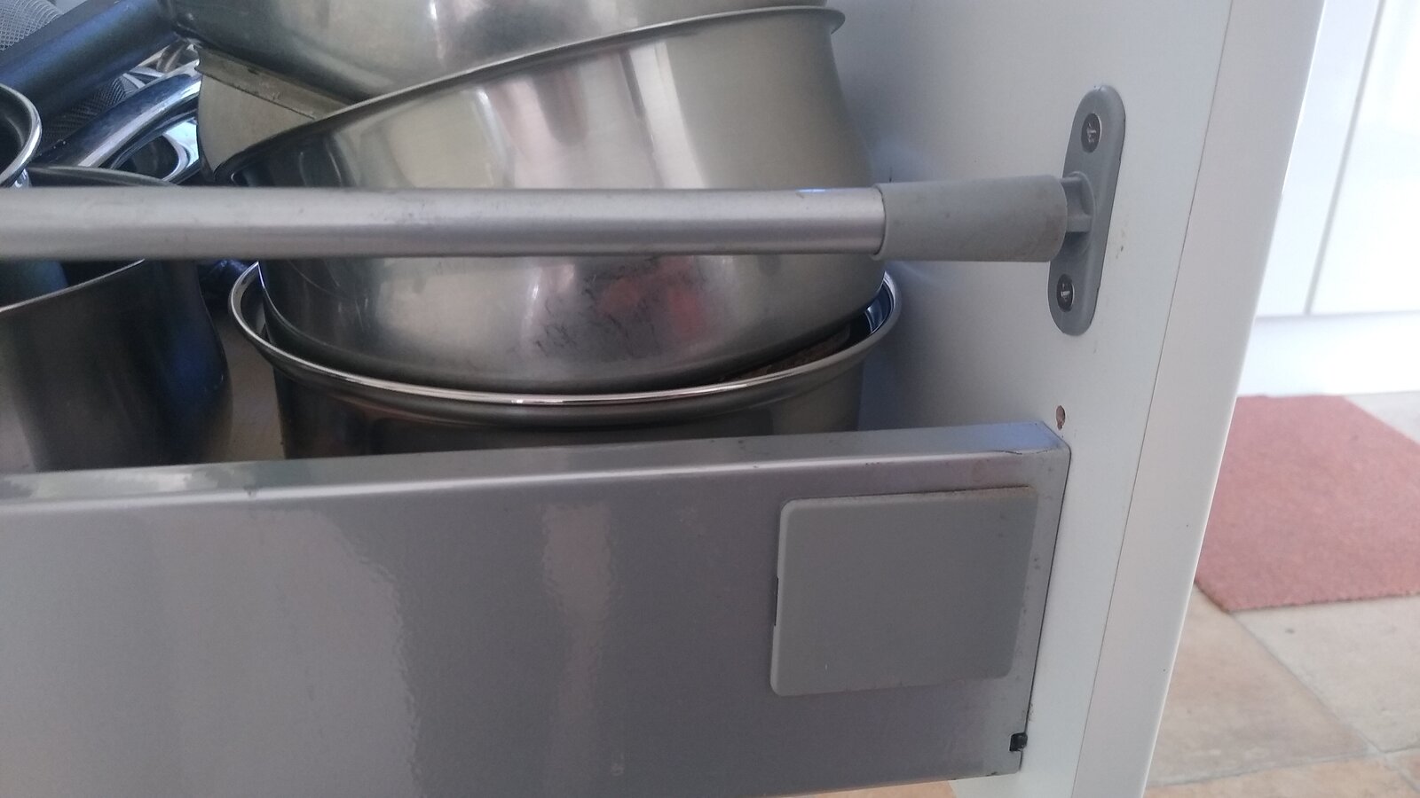

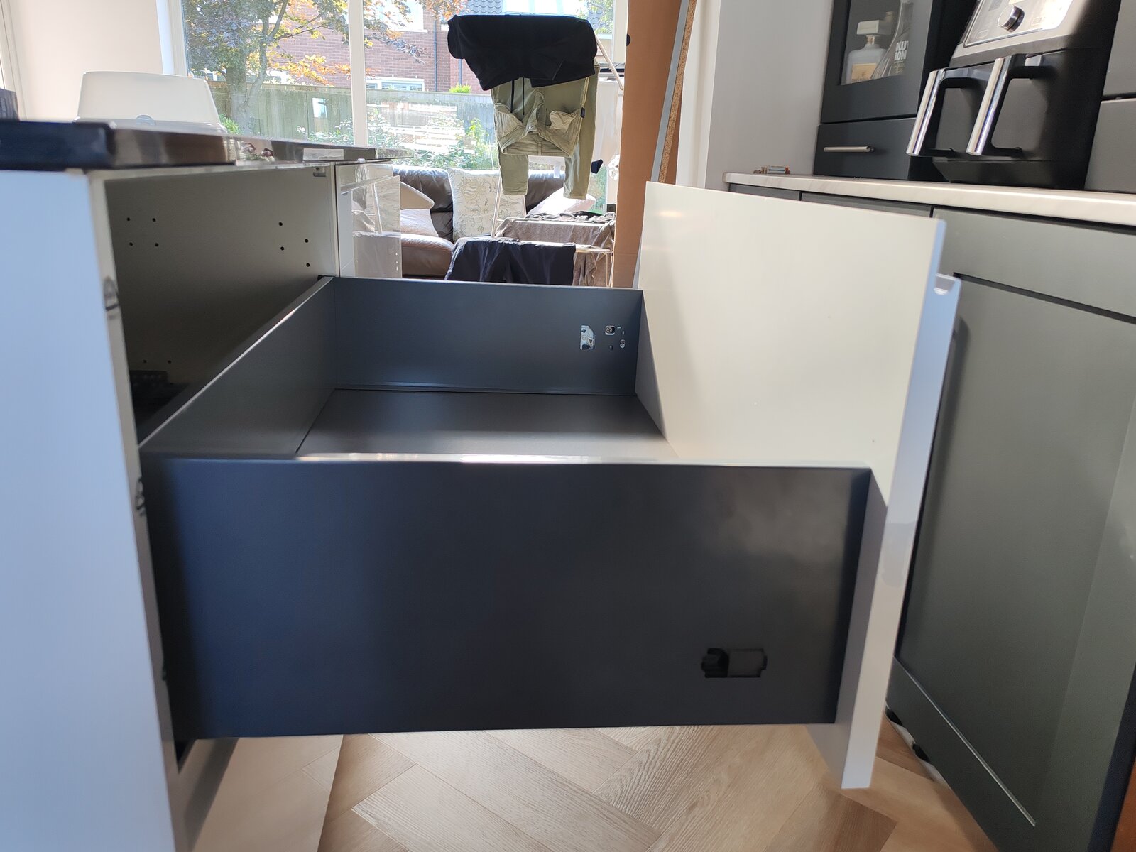

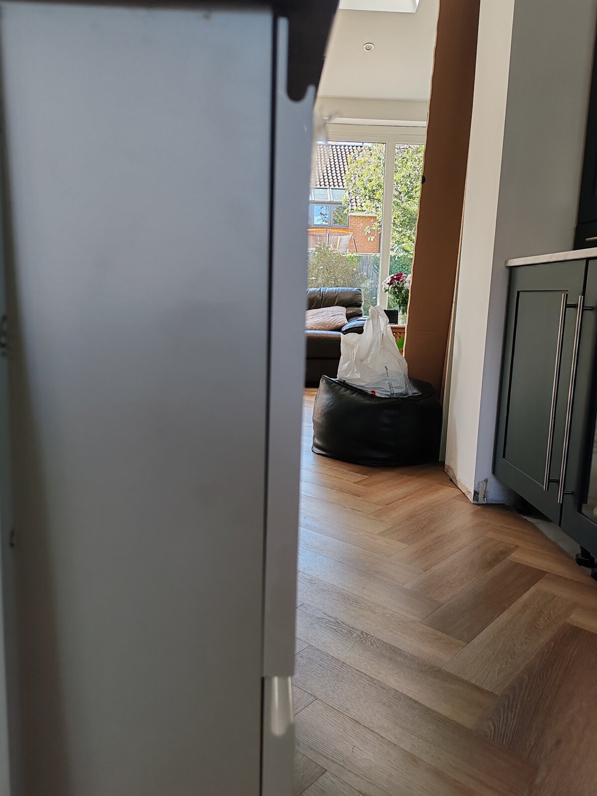

We bought a couple of 800mm drawer bases and have fitted 2 deep drawers in each.
Can anyone explain what's causing the upper drawer fronts to tilt outwards at the top (see pic)?
The frontals are only adjustable up/down or left/right.
Ive got the same ones, twisting the side rails will move the top of the fronts in and out slightly
Ah right. I didn't see the image. Our drawers don't have those rails.
Thete looks to be an adjuster inside and out on the side rails? if so are they at different heights
The outer slots are too release the drawer from the runners. The inner ones adjust vertically and horizontally only.
I've had a muck about with the runners themselves and have managed to straighten up the drawer. Not confident it'll stay that way with any real weight in it.
The bars that @lostinthelight mentioned are normally used to tilt the (top) front of the drawer. I have no idea why your drawers don't have them, and yes, I agree that it is likely that once you load the drawers up, the runners will shift downwards.
