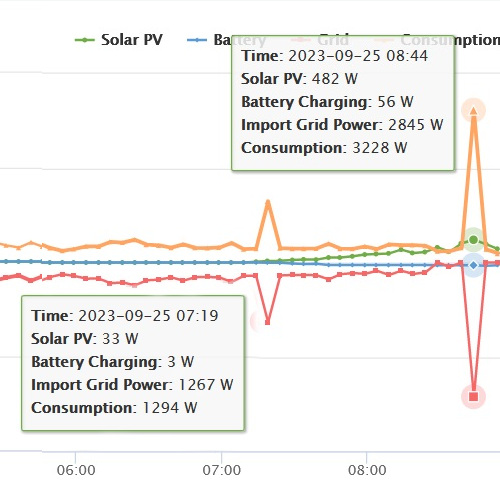

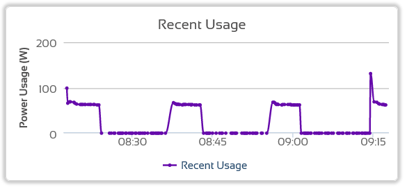

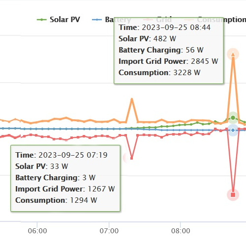

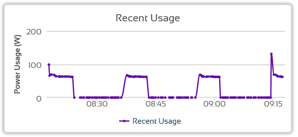

I now have a computer display of power being used 1695632152323.jpegand I have a back ground usage of 250 to 500 watt, some will be due to freezers, and some the multi-one-watt stand by power usage, SkyQ uses more, around 24 watt as LNB is powered, but been going around with a power monitor and not finding what is using the power, the freezers are running this 1695632125856.pngis the chest freezer, they average out at around the 120 watt mark for all four, which only accounts for half the back ground use, and turning off the front and rear ring final circuits with the clamp meter on tails I know about even use front and rear of house, and not freezers as they have a dedicated UPS supply.
The two spikes shown, first is a mystery, 1294 watt, looked at iboost+ shows zero watts saved, and both wife and I in bed, I know freezer auto defrost but that's around 160 watt, second 3228 watt was me making coffee, it's like big brother (wife) watching, and the where's my coffee question.
But 60 to 250 watt OK freezers, but seems I have around 200 watt more than I should, not the cost, just interest, where is it going? Since socket circuits easy to check with plug in energy meter, and I am sure will find in the end, but all smart meter users must have had the same, so ideas please.

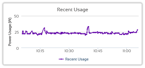

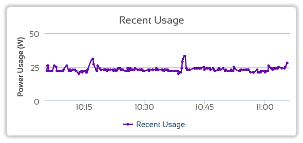

Good point however the clamp on was around the tail to the CU and turning off the two main house rings got it down to nearly zero, tested this PC 1695636533076.pngso around 25 watts, I have three plug in energy monitors, two linked to PC, and two without on/off so prefer to use them with essential services, I will in the end find it, but now looking at items where plug not easy to access.

On fridge/freezer used by daughter, however we really do need to reduce stock and except for Christmas stop using one of the freezers, however the energy meters are showing an average of around 25 watt per freezer, so all together we are looking at around 150 watt, and clamp on is showing around 1.2 to 1.6 amp or 276 to 368 watt and the freezers are not included in that as fed from the UPS supply.
