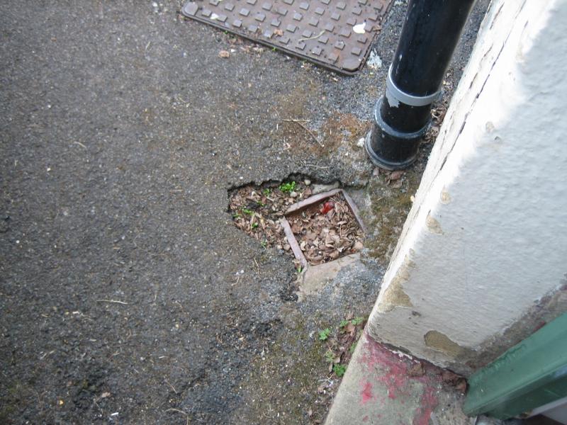

We're having a little tart up of our back yard and I was hoping to get some advice on how to repair the existing tarmac/asphalt around the drain gully and a drain cover.
I've taken some shots of it
Can anyone recommend any products/methods to repair it??
Thanks in advance.
you can buy cold patching tarmac in small bags from builders merchants. cut back the areas to get a neat line and then the tarmac is placed in the area and flatten down and compressed to get the finish. Or use some black dyed mortar, but it will fade over time.
