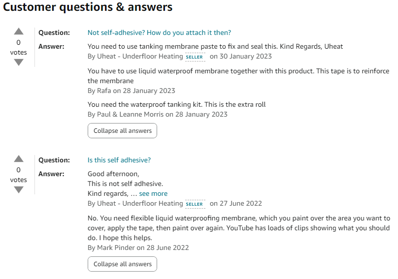

That looks like the Mapei tape that is included with their tanking kits - it is not adhesive, but is bedded down into the tanking compound; it's used to reinforce corners and joints...
Could anybody recommend some self adhesive tape for this purpose please? Ta
You need to use a liquid adhesive to 'stick' your sealing tape mentioned in your first post (like the mapei ). Works almost like plasterboard jointing tape and filler
Either that or a self adhesive waterproof jointing tape that are supplied for use with backer boards, lots of proprietary makes available

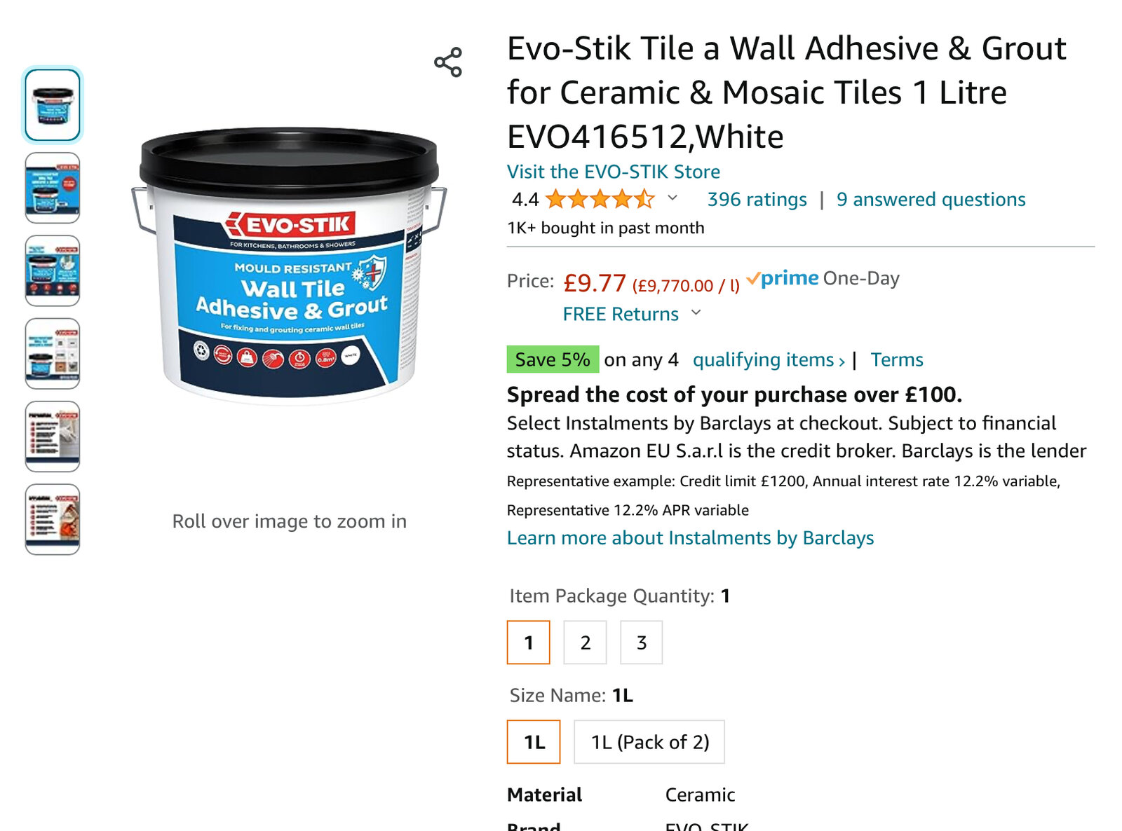

Is it worth taking the chance for the sake of fixing some tape? If you have the joint sealing tape already then just use any adhesive type material, even water resistant tile adhesive thinned down to a yogurt type consistency will do, paint it on the surface, stick on the tape, paint more over it and then use a wide scraper to flatten out and leave to dry.

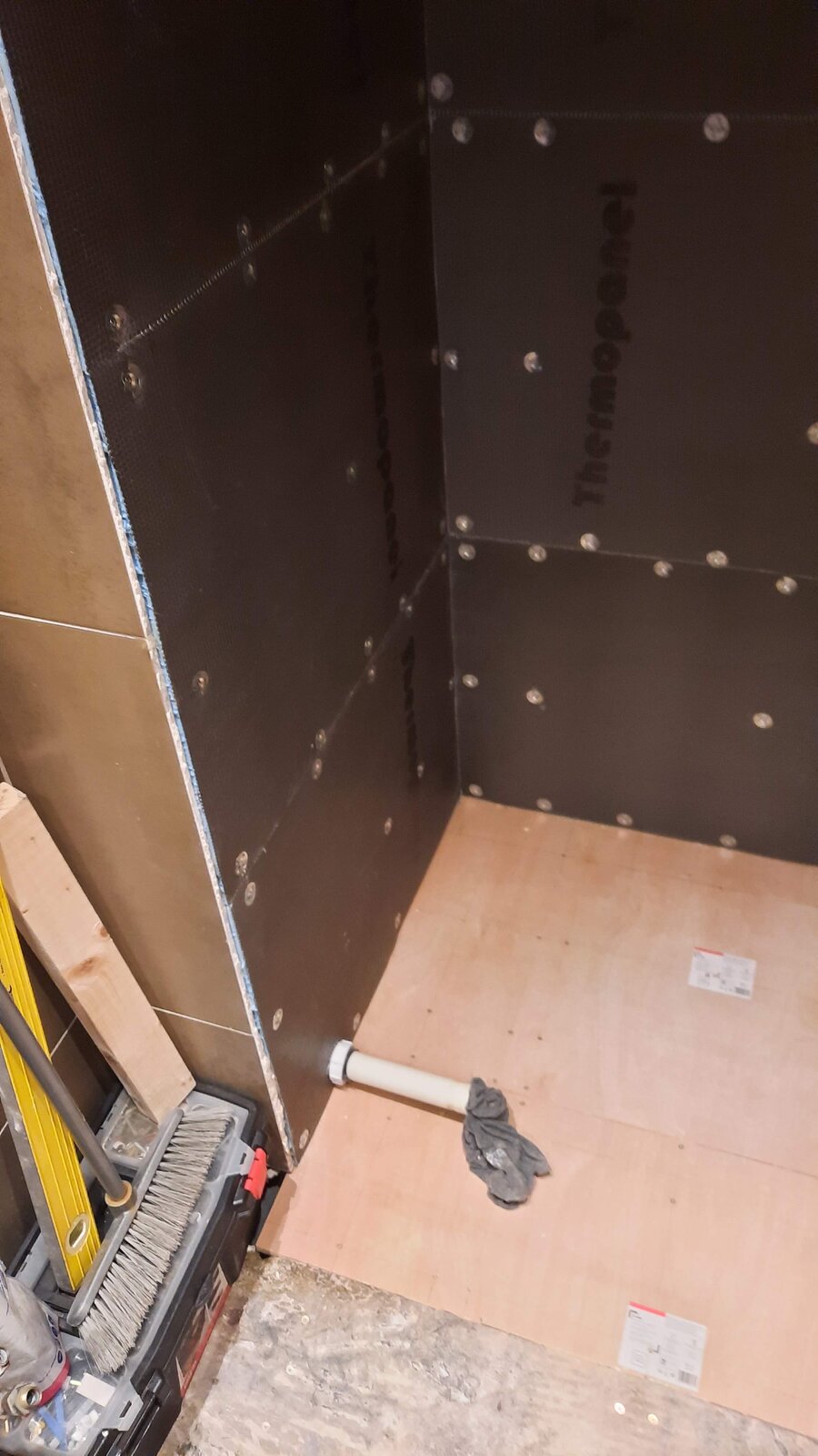

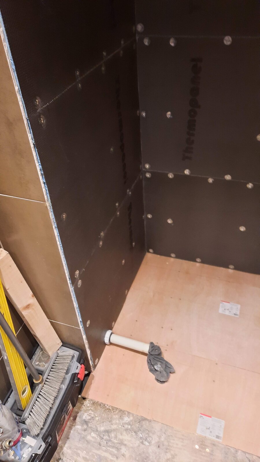

I have attached a picture of my current progress, my next steps are as follows.
Fix the tape to the backer board joins horizontal and vertical
Install the shower tray on self adhesive legs, the last shower had a flexi pipe are these still used?
Seal the tray to the 3 wall edges with silicone
Install the corner trim
Not decided on bottom trims yet or fix direct to the tray with silicone (help please)
The boards are 8x4 so the only joins will be in the corners, top and bottom, looking for the safest method of no leaks here please
Install shower
Install door (not bought this yet)
Next job, learn tiling for the floor lol.

Install the tray on self adhesive legs?? ... i.e. a riser kit?
Really hate to say it but if possible, please don't, riser kits are terrible things and they are not reliable longer term. Lost count of how many showers I've had to repair after a riser kit has allowed movement in the tray and the wall to shower waterproof seal has eventually gone. They do not support shower trays properly. You should really build a plinth so the tray will sit flat and steady.
What is the tray made of?
