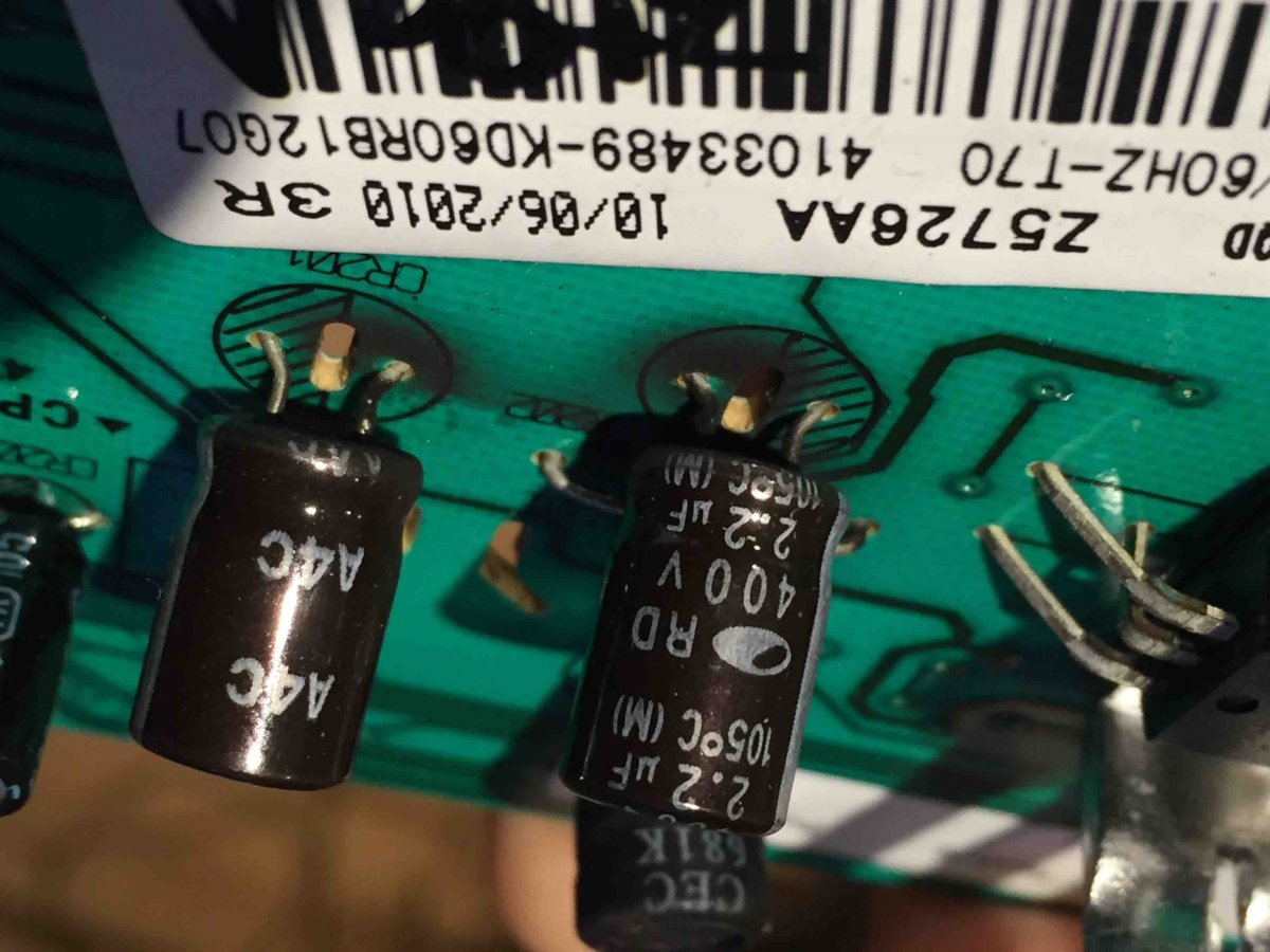

so - got a candy GO FS 262-80.
had it a few years - basically picked it up from a rented property as everything had to go - so unsure as to how old it is, but its always worked nicely for me.
recently noticed the element was gone.
no problem - removed element, ordered a new one - refitted - tested. brilliant.
took the opportunity to give everything a really good clean out - there was a decent amount of junk removed, only hardened lime scale and other such goo - no objects of any kind.
put it all back together, run some tests, everything seems fine - do a hot wash with laundry inside to give it a full run through -
cycle eneded perfectly.
next morning i put the back plate back on a move it into its cupboard - set a wash off and it kicks violently into life with a terrible screech - so i pulled the plug.
everything is connected properly water on power obviously on -
after some investigation and re dismantling i notice the plastic sheet surround has drip and run marks. and a strong smell of fabric softener. a poke around the PCB and it looks like a few components are fried.
and by the way the dial buzzed - possibly thats gone aswell.
i cleaned the plastic surround and the circuit board with ipa delicately - and put it back together - situation currently sits with the machine powering up - no jerks screeches or buzzes - but when the dial is turned to a cycle - it initially operates normally - dial clicks but then it freezes and the cold wash indicator flashes 5 times.
i understand this to be a blocked line or pump failure -
so went through the plumbing again just to check if in the move i knocked a lump of goo loose.
nothing -
im assuming an electrical component on the board related to the pump / intake / waste lines is dead -
im keen not to give up on it but at a point where my knowledge is weakening.

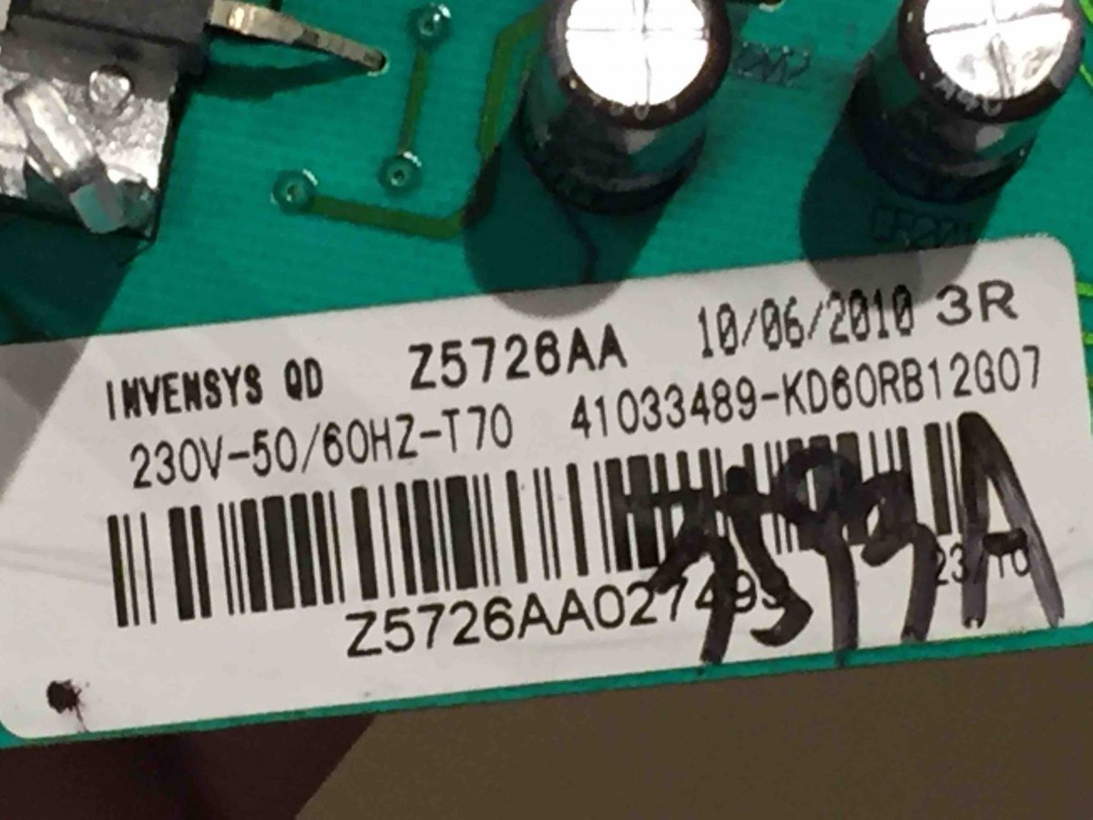

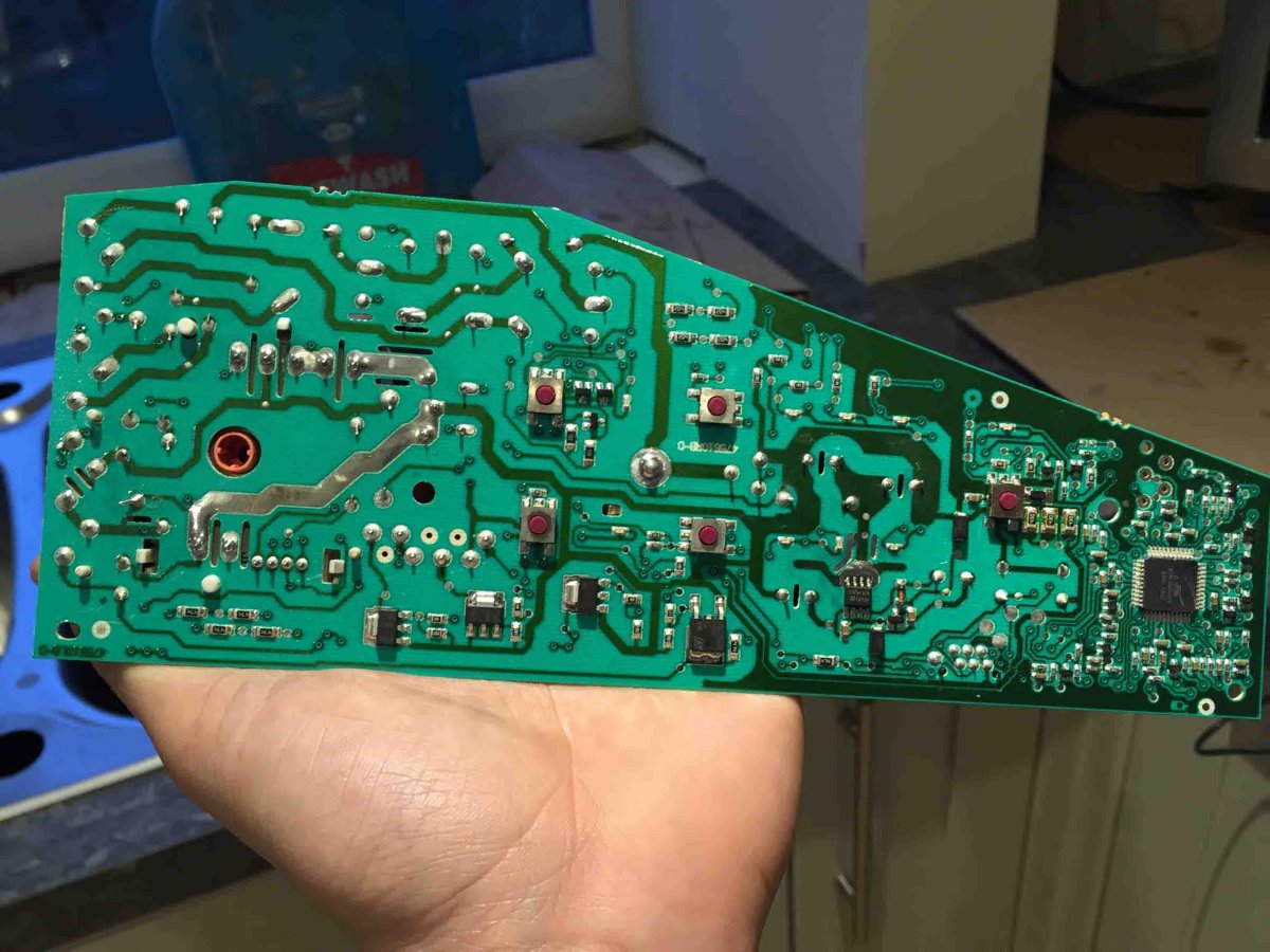

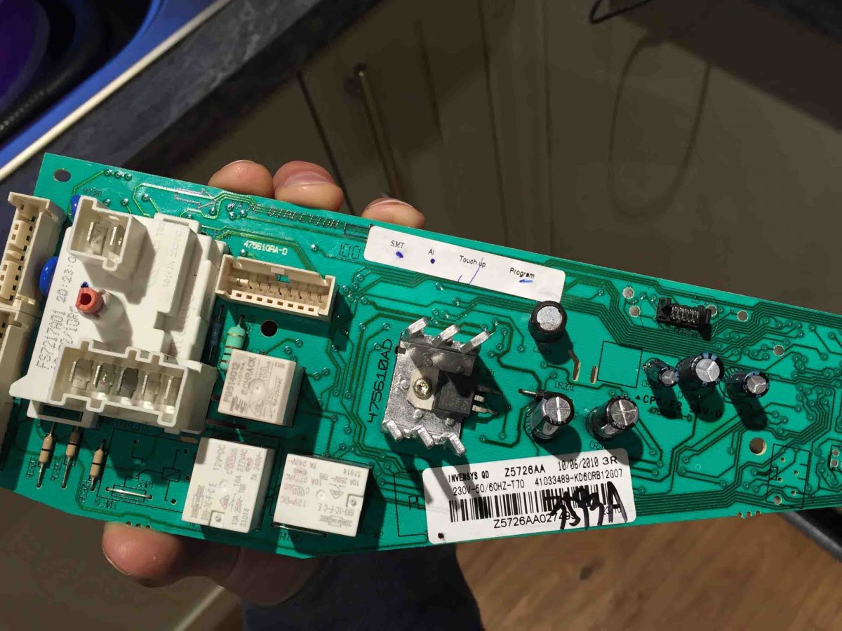

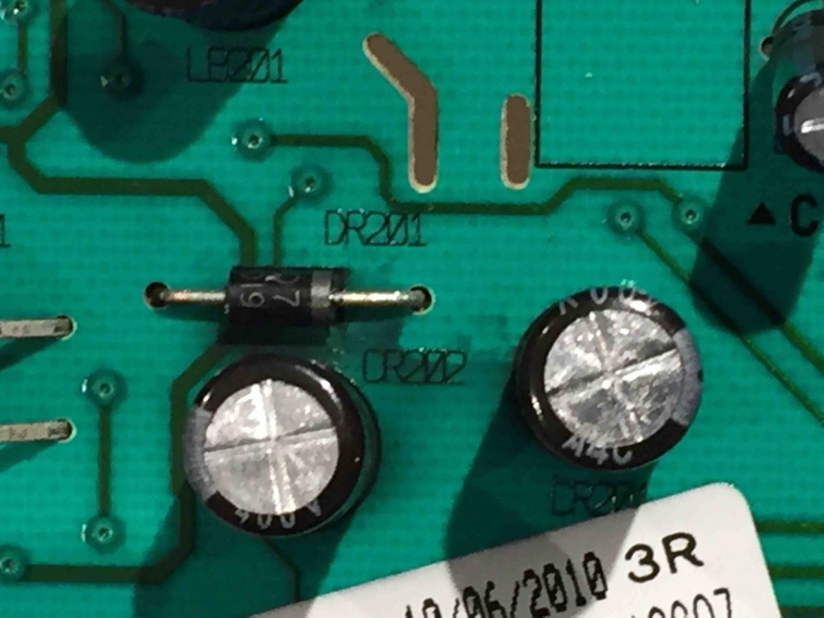

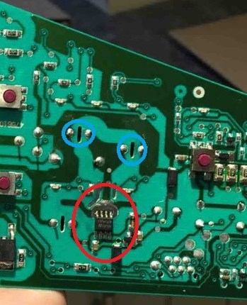

ive attached photos of the machine and the offending components -
one shows the three offending components, coded DR201, CR202 & CR201
all three look a bit charred - components CR201 & CR202 have definitely burnt a leg each. all three components fail continuity tests.
the switch seems to work - i continuity tested it and it opens and closes the circuit at all the appropriate times. so im guessing thats fine.
my question is - do these symptoms and the machines behaviors add up?
the parts i assume think are 2 capacitors and something that look like a resistor but im not sure it is one. its hard to see any of the printing. how can i get my hands on replacements? im happy to solder away but im not knowledgeable about the correct parts.
please help!!!!!!!!!
