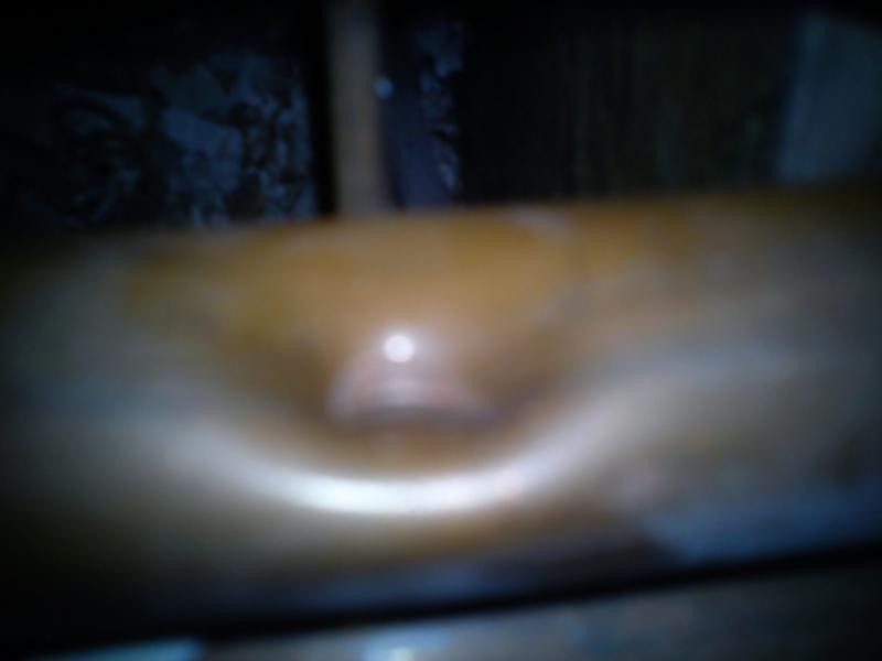

Have just lifted a floorboard to find a very badly dented central heating pipe. It is intact, not green, not leaking, but has quite a deep, pointed crater about 7mm wide, a few mm deep, into one side of it. Copper looks a bit stretched and thin in places though of course I can't really tell.
So - no problems yet - but am just about to lay engineered wood flooring over it. It is on the first floor. The pipe is very tightly fitted and not very accessible, twisting through a tight section of joistwork where several meet.
Not 100% happy to just leave it alone long term given the permanent flooring going down, but my thought was that as it is not leaking at all, could I just reinforce it using epoxy putty? I only have access to one side of the pipe, I presume the putty does not need to go all the way round. The side with access has good access so I could get quite a thick section on it. Is it robust for central heating pipes, and would there be any danger of it further weakening the bit of copper it bonds to?
river the only acceptable repair is to cut out the damaged section and replace with a short length of pipe , if only for peace of mind.
any chance of a photo to make a more informed choice although i am unlikely to change from the above opinion even though for you it makes considerably more work
Thanks guys, guess I'll just have to bite the bullet and do a proper job! Annoying because looking at the positioning (side on) I'm strongly suspecting it was installed like that ...
