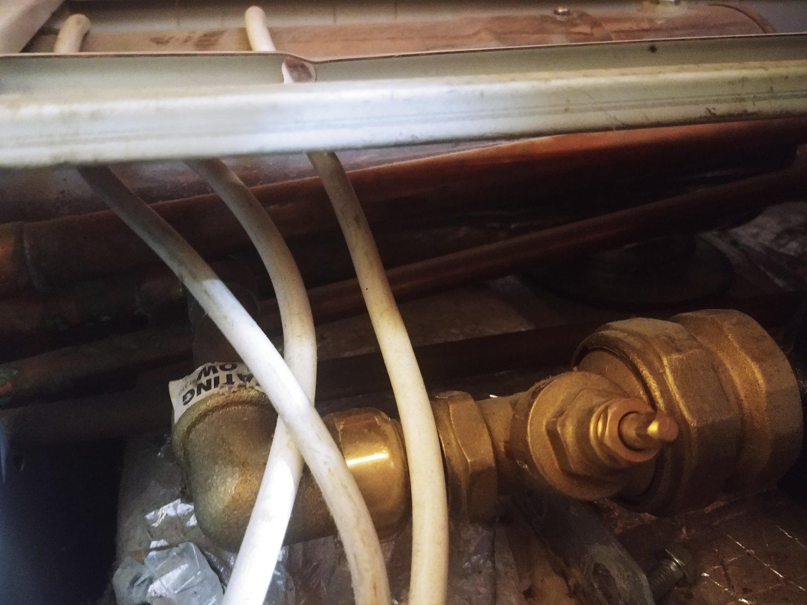

We are in some sort of hell with our 2 year old Grant Boiler. It was fitted by a local company that has now gone bust.
It hasn't worked well until we had it serviced by an unconnected chap a couple of months ago. It's an oil fired floor standing Vortex Eco model.

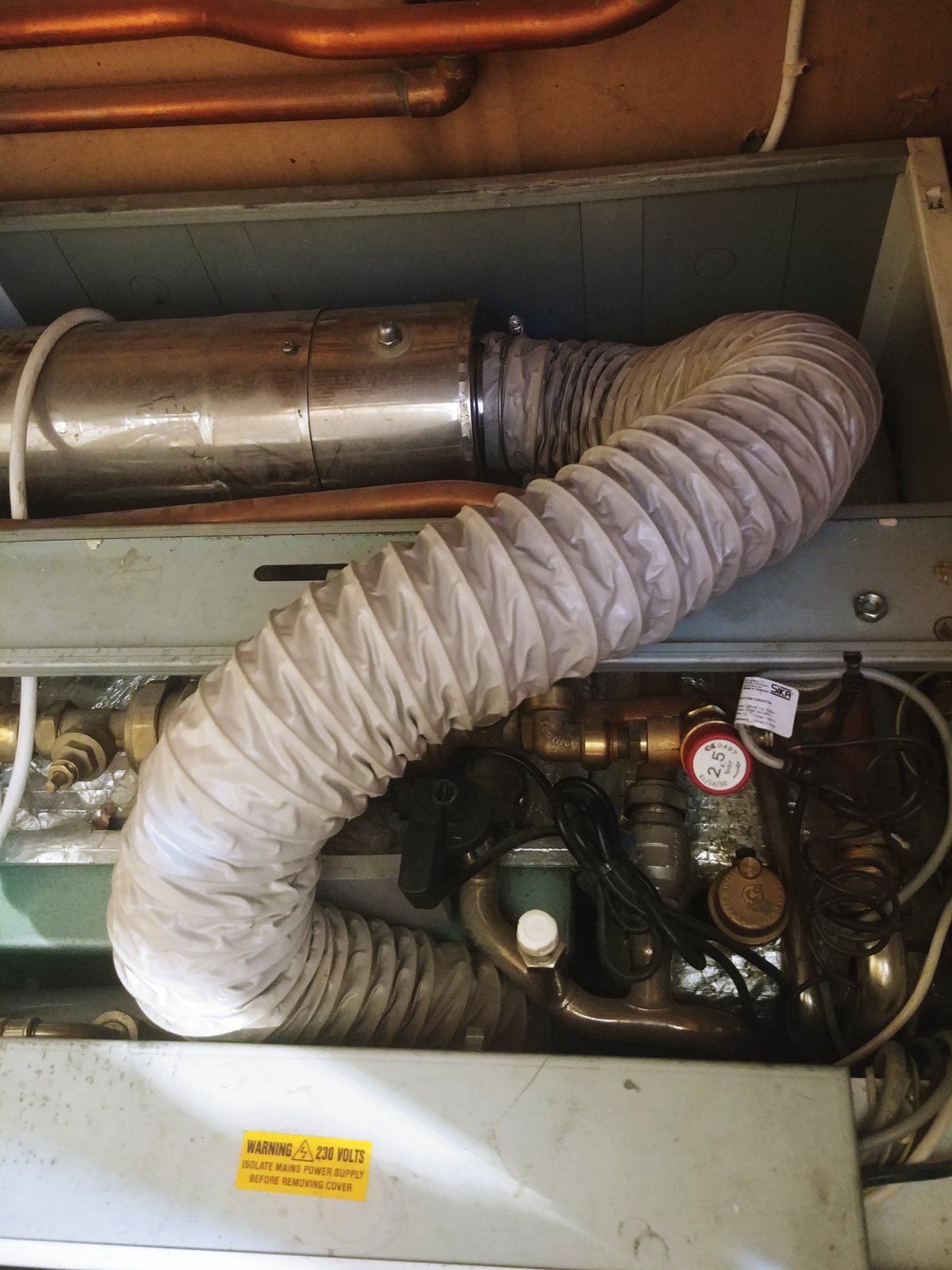

The original fitter did not connect the Snorkel tube but worse than that, he ran the pipework inside the boiler casing, so that we can't feed the snorkel tube underneath the metal brace that runs across the top of the boiler. At the moment the lid of the boiler is off and so that the tube can be fitted.
The boiler is working beautifully now, but the cap who serviced it and noted the snorkel problem doesn't want to de-install and re-install it properly and we're struggling to find a solution. The house is on the market so we need to sort this.
First question is I assume that the snorkel tube is actually required?
Simon
