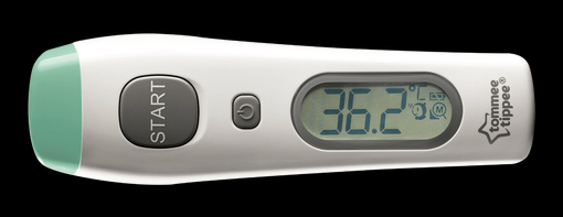

I think the proper way is to measure in and out temperatures, I tried with one of these thermometer.jpg they can be set to read object temperatures, but the results fluctuated wildly so did not work. Using the electronic head I get current and target, TRV_report.jpg so I used that for the final little bit, if current exceeds target then close a little, once done I was surprised how well it worked, the model of TRV head I used was OTT with anti-hysteresis so set at 22°C at 7 am and 20°C at 8 am or it would take to 10 am before fully warmed up, and it could not stop morning sun in bay window causing over heating, but in the main once set it was spot on, no need for a wall thermostat to control room temperature, although still need one to turn boiler off to stop is cycling on a warm day.

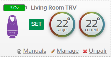

The TRV (Energenie MiHome) also have the ability of geofencing, but unlike the Wiser system, they don't have algorithms to work out when to close, and the anti-hysteresis is OTT so in mothers house when setting changed to 20°C it would heat room from 14°C to 18°C fast, but 18°C to 20°C was painfully slow, so would set to 22°C for one hour then back to 20°C.

However the Energenie has two sensors one for water and one for air, and compensates for the heat from radiator.
The problem is you need to read the instructions carefully to find out about these features, and some features change, I was told when getting Energenie they worked with Nest, however it seems support has been withdrawn, also seems to work wrong way around, Nest tells Energenie not Energenie telling Nest.
