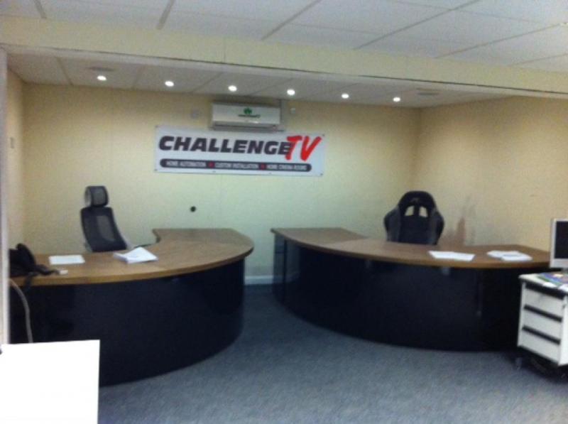

We just made these mirrored desks with gloss black laminate fronts and walnut veneered tops. The black cured desk fronts were made the same way as an aircraft wing, so they were very very strong and would not move out of shape so we did not bother to balance the backs.
