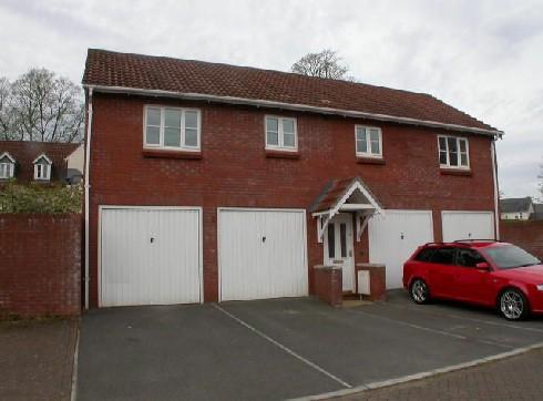

Hi,
I am buying a detached coach house and would like to put a balcony on as it has no garden. There are 4 garages under the coach house and 4 parking spaces, one of which is owned by the coach house. Problem is the lounge window is over another person's garage and my garage is below the hall window.
The balcony would not overlook anyone as it would look directly across the street towards 3 existing houses so it is not looking directly down on someone's garden.
Has permission ever been granted for a balcony on a freehold modern coach house? Could the owner of a garage object if the balcony was above his garage? Could the house owners object? Is it feasible to put the balcony above my garage although it would be under the hall window?

Have uploaded photo under my Album. I own garage where car is parked.
Ahh, a picture speaks a thousand words they say! :p
So I'm guessing you want something like this in principal, the one pictured is pig ugly and was just the first one Google threw up BTW. In an ideal world across the full width, otherwise just above your garage, converting one or more of the doors into french doors or similar?
It would be prudent for you to try to talk to 'the duty officer' at your local planning department and tell them what you want to do. You could try to set up a meeting with them to go through it rather than over the phone and take a few photos of your house and your neighbours and maybe a printout from Google Earth with you when you meet them. All local authority's are different though, some are more friendly/helpful than others. They will not charge you for advice at this stage.
From a practicalities side of things I am no structural engineer but I would guess that it would be possible without posts for supports as per the one above. It would need designing properly though and would also need to comply with Building Regs.
