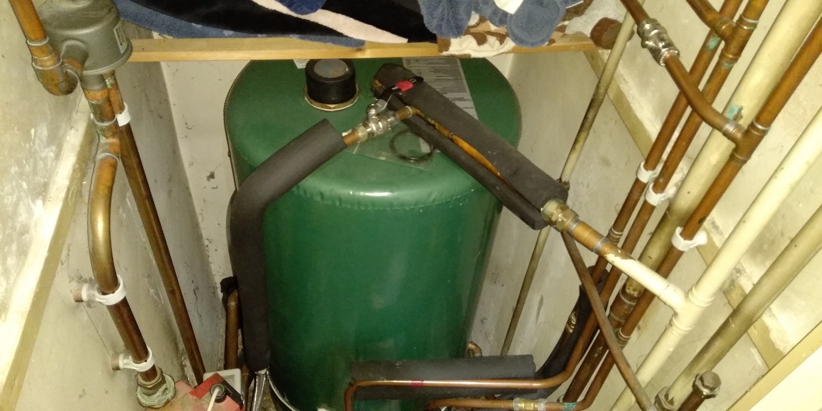

Popped to the shops came home and put the heating on, heard a bit of banging and clanking which sounded like it was coming from airing cupboard where hot water tank is. Shortly after that boiler (baxi solo 2 50 pfwent out...

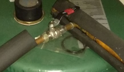

Not sure what i'd be looking for to be honest, i had a look up in the loft at the expansion tank and it was full of murky water... i cleaned it out yesterday using a couple of bungs when adding the inhibitor
Googled manual air vents and went for a look, couldn't see anything ..
