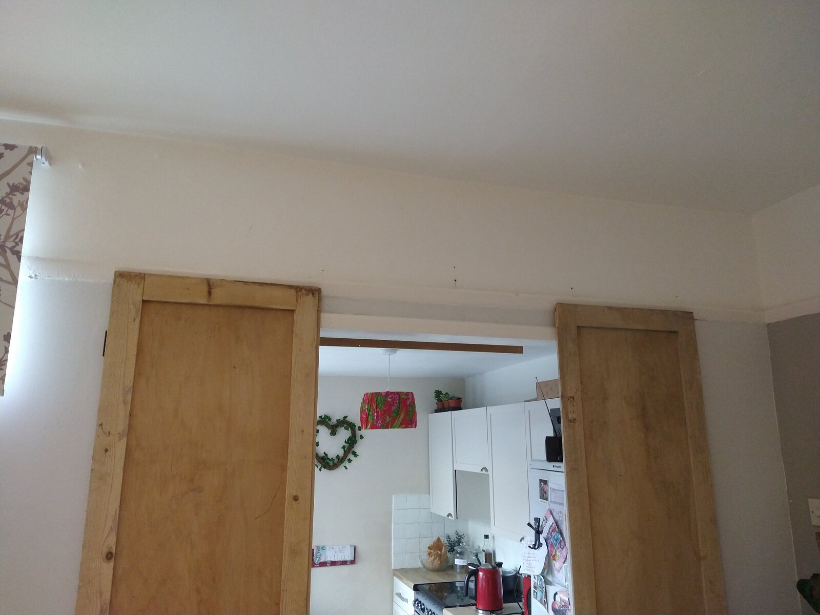

I'm wanting to install a double barn door over the kitchen opening to keep out pesky pets whilst cooking.
I have the doors and track kit all ready to go however due to having a picture rail and coving around door will need to install a panel for the track to sit on to give it some distance from the wall.
This is when I've run into the problem: I can't for the life of me drill far enough into the wall to put any screws or wall plugs. Some of the holes have gone in about 2cm, some I can't even get 2mm before hitting what I'm guessing is metal. I believe this used to be an external wall (1840s Victorian 2 bed terrace-kitchen probably added on as extension) and I've encountered a metal lintel above the door?
Is there any way I can get a panel on/does anyone have any other ideas?
Thanks so much in advance!

Might Also be a concrete lintel.
What type drill are you using - battery, mains, SDS?
Otherwise get a SDS Drill:
https://www.screwfix.com/c/tools/drills/cat830704#category=cat830818&sort_by=price
Or some No more nails onto the wood along whole length and some clamps to pull it onto wall whilst it drys.
Issue with that is that it is a painted wall so only as stong as the paint.
But more length makes for more surface and more strength.
Or longer wood than lintel, Screw onto wall at far left and right and also use no more nails entire length.

I've actually just tried with a different, fresh drill bit and managed to go a bit further into each hole with red&grey dust coming out, I guess you're right then about the concrete lintel!
The drill I've been using is an erbauer battery combi, I've tried both the hammer and regular settings with similar results.
Fingers crossed I just need better drill bits to get the holes deep enough for the wall bolts (30mm), if not I will definitely take your advice on adding a longer strip of wood
