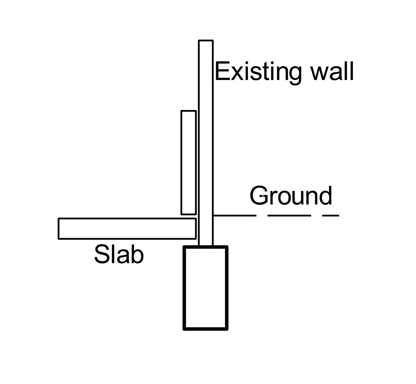

Considering this slab will be built right up to the side wall, how do I ensure that it does not move away from it? I can tie the walls with wall starters or wall ties, but the base is floating, and it does not look a great idea.
I drew a sketch

Just out of interest, are you going to build directly on top of the slab or will you also have footings under the walls too?
No I will build straight on it, that's the current idea. The builder wants to avoid unnecessary work, in this case digging extra.
I drew a sketch
You cant stop differential movement. Use wall starters and silicone the joint -is all you can do
