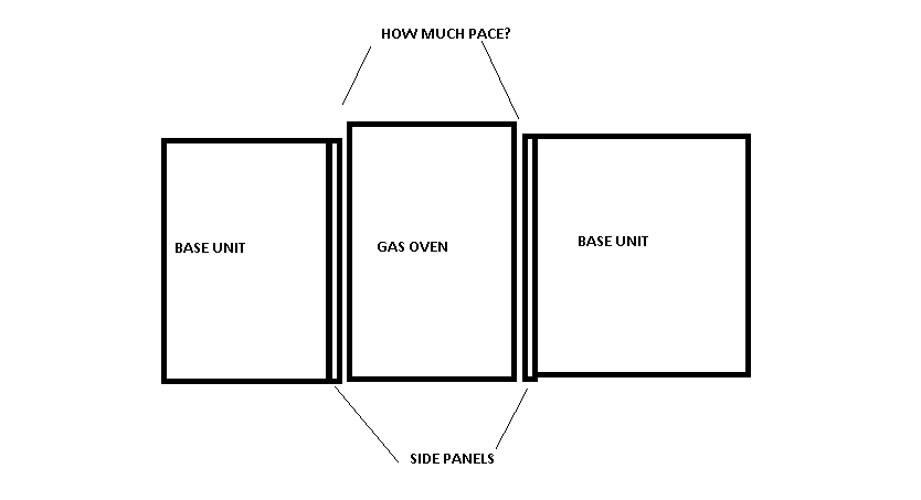

I am fitting few kitchen units, have 2 questions:
1. Space between oven and units, is 5mm enough so can pull in/out if required? Pls see pic below.
2. I need to cut few panels, they are gloss mdf, some painted others wrapped. What's the best way to cut for smooth finish, not damaging edges paint / vinyl? I have a jigsaw but can invest in a circular saw if had to.
TIA

5 mm is a bit tight.
I usually leave 10 to 15mm depending on kitchen layout.
To cut the panel ideally you need a table saw, otherwise a circular saw with a good blade and a guide to go straight.
Practice on a scrap first to see how the blades bites into the panel wrapping.

Do you mean 10 to 15 mm on each side?
Agree, I should invest on a circular saw, would 60 or 70 tpi good enough?

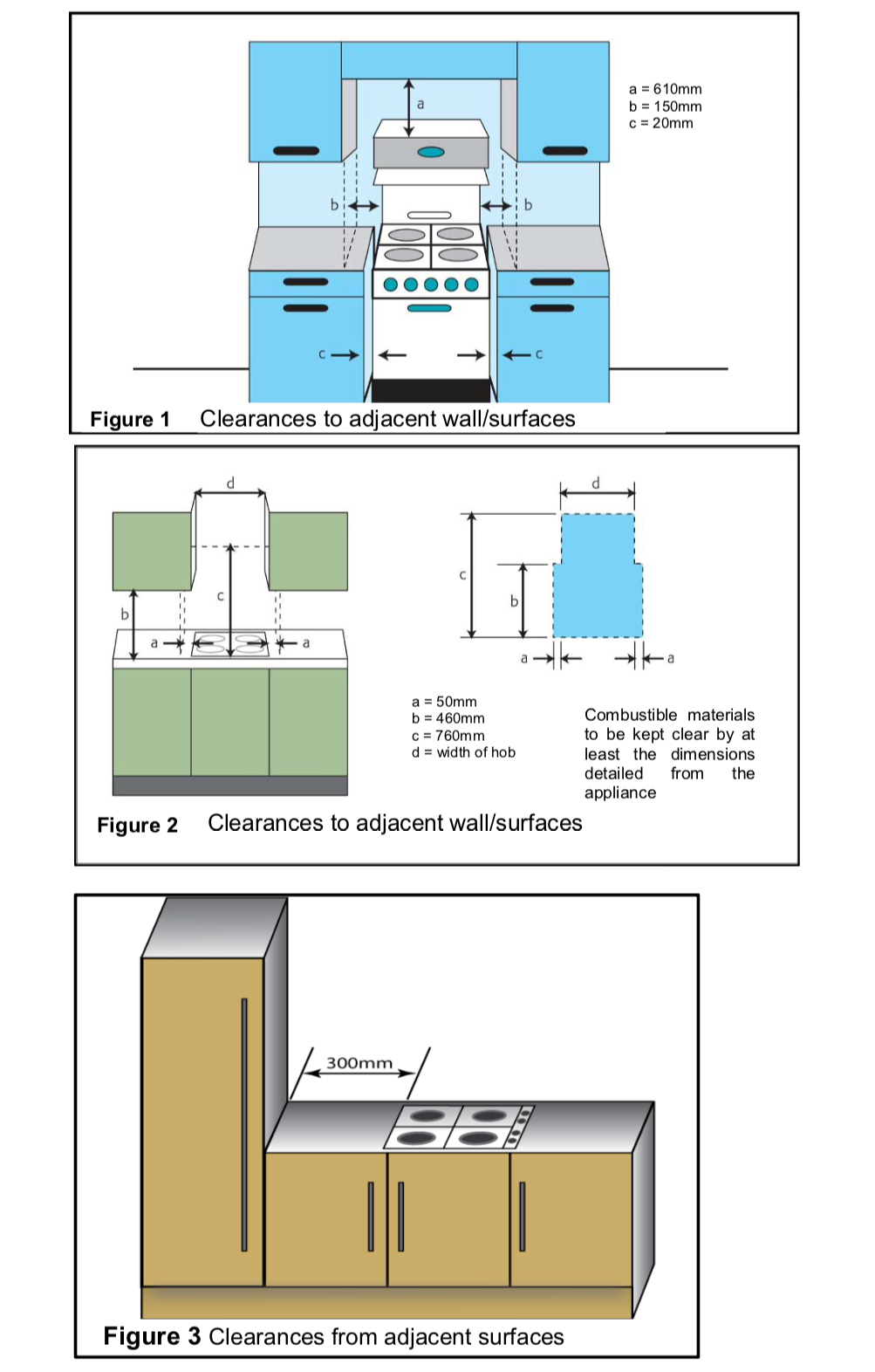

Better looking in the cooker/oven instructions especially if it’s a gas one. These will tell you how much you’re allowed either side, above etc. If you can’t locate the instructions then ask the manufacturer if it can be fitted to BS6172.
I have looked in cooker installation instructions, there are few things to take care of mainly about distance from wall units and wall behind but no restrictions about my question above.

Have another read, it might say walls/surfaces. This is an extract from BS6172:

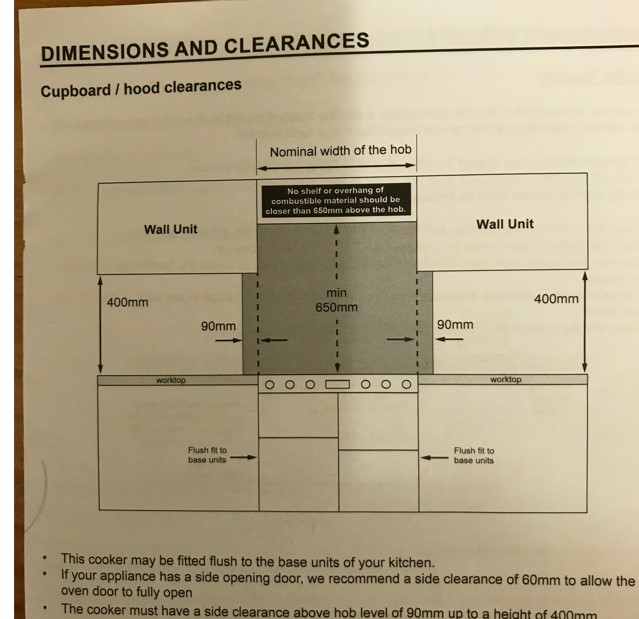

I said above, I have read cooker installation instructions, in which states clearly "cooker may be fitted flush to base units", see below.
You asked if 5cm is enough yet you know they can be fitted flush? :confused:(n)
I was asking from practical point view, if and when cooker needs to moved out for service/repair/replace...etc.
In my experience, the more flush they are, the harder they are to get out yes, but 5cm should be enough (y)
