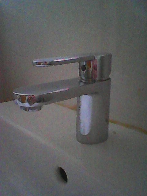

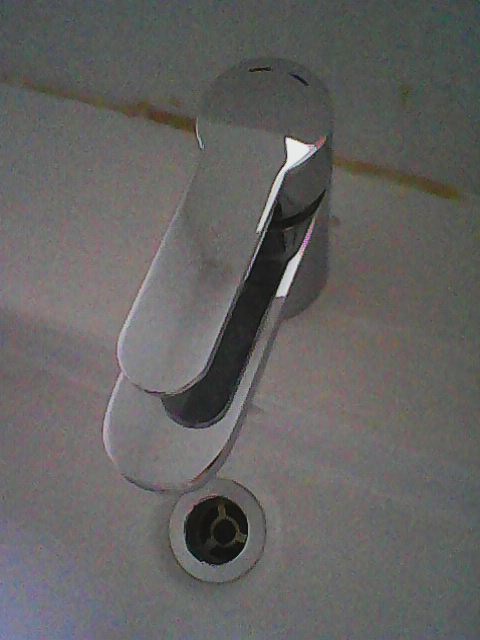

Hi there !
I was wondering if anyone could help me ?
I have a basin tap in my house which has zero manufacturers markings that I can see.
Hence I have no idea who made it.
By any chance does recognise it ? I have attached a couple of pictures.
Kind Regards
1. No idea who made it.
2. If you want to replace the cartridge:
2a. Isolate hot and cold.
2b. Put plug in basin.
2c. Take handle off. Almost certainly lever out little plug under flat part of handle and undo grub screw but do not take out completely. Probably Allen grub screw 2.0, 2.5 or 3.0 mm. Pull handle off after undoing screw.
2d. Remove cartridge (see below).
2e. Measure cartridge dimensions and find equivalent one. Have a look at tap-spares.com.
3. The cartridges are usually held in by a ring threaded into the inside of the tap body. Some can be removed with a normal adjustable spanner, some need a special tool, lots of imagination. or brute force. If you get stuck undoing it, post another photograph once the handle is off.
