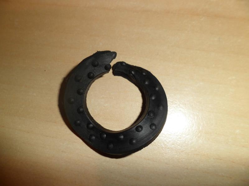

Hi,
Not that long ago with help from this forum I fitted some new basin taps in my bathroom.
Unfortunately each has been leaking a tiny bit from the rubber washer which sits above the backnut.
I've removed one of the taps this evening and the rubber washer is split where it would have been seated towards the rear of the tap which is presumably why it was leaking a tad.
The taps are standard 1/2", the hole seems rather large and has a diameter of 1 1/4" - is this why the rubber washer(s) have split? The basin is quite old - approx 20 years.
Here is a pic:
How can I fix this please? Is there such a thing as larger rubber washers for 1/2" taps?
Many thanks in advance.
I'm thinking that the rubber washer should be between the tap and the basin. Tightening the back nut on to the rubber washer will just ruin it
Sorry I'm getting confused with the terminology, I fit the tap with the rubber washer under the basin, top hat and then flexi tail.
So I should have put the rubber washer under the tap, then under the basin the top hat and flexi tail?
Why do the installation instructions in with the taps and on the web show the rubber washer underneath the basin? Does it need to be on top because the hole is bigger than normal?
Bit confused..! Cheers.
Yes, washer between the tap and the basin. Then under the basin should be the top hat and flexi only.
I have not read those instructions but they are clearly wrong as any plumber will tell you.

Yeah the MI has it the wrong way around, rubber washer should be on the tap body against the top of the sink, to protect the surface and lessen movement, not underneath. If anything, as Tony say, there's sometime a harder plastic one underneath but you're using a top hat. A little squirt on silicone against it wouldn't hurt either, just a small amount.

Can't agree with that charnwood, as far as I'm concerned top hat washers are for stabilising the taps and stopping them from spinning. They may well help with thin stainless steel sinks too but don't forget they make 3/4" as well as 1/2" ones.
