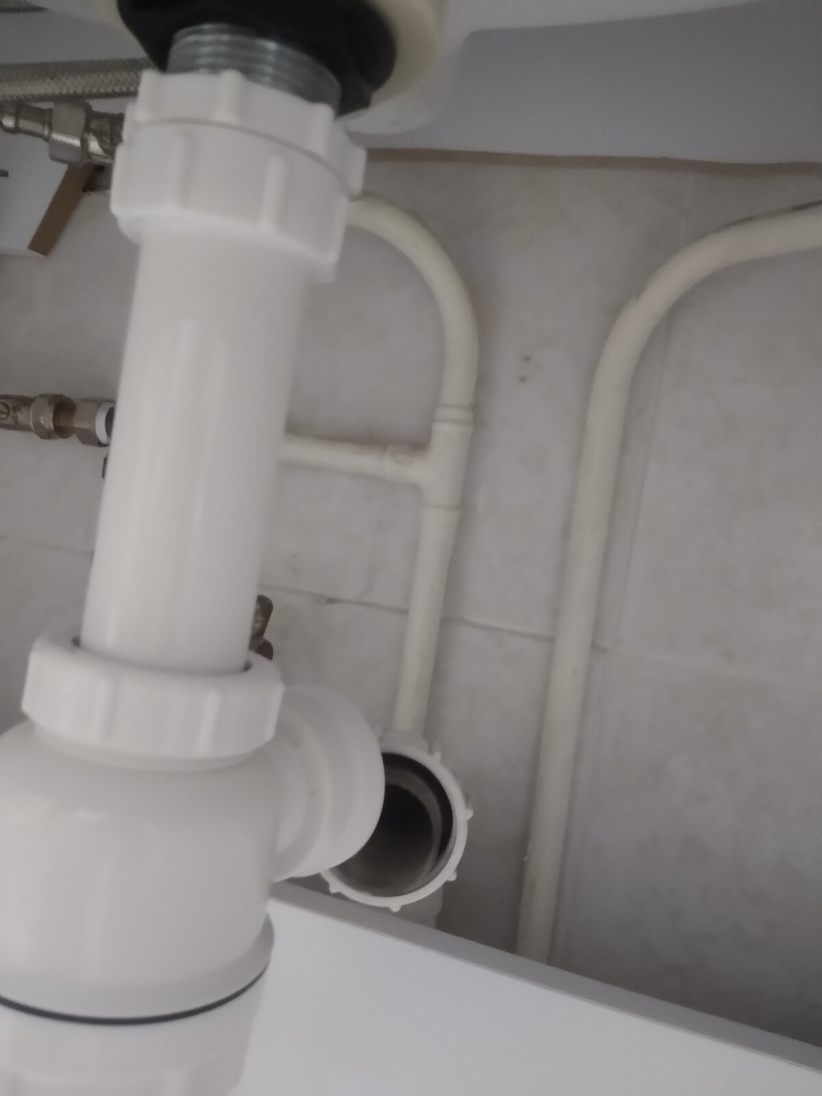

Hi all,
I've replaced my old pedestal basin with a vanity unit.
There are 2 issues: as you can hopefully see in the attached photo, my waste outlet is slightly out of line and angled and my new fully extended bottle trap is slightly too short
What's the easiest way to resolve this?
TIA
Extend the waste pipework to meet the trap. Short lengths of pipe ,one coupler and one elbow required.
