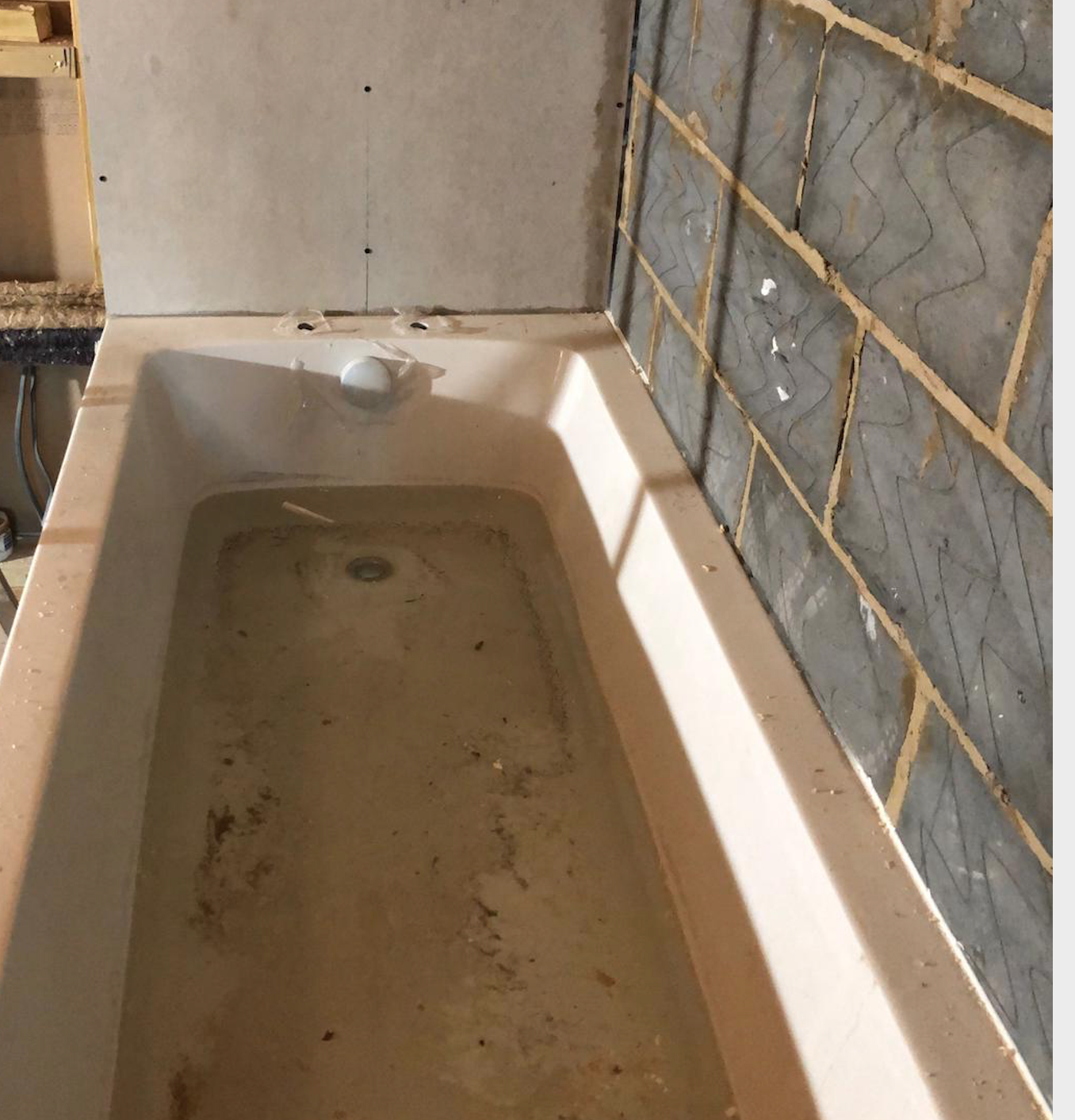

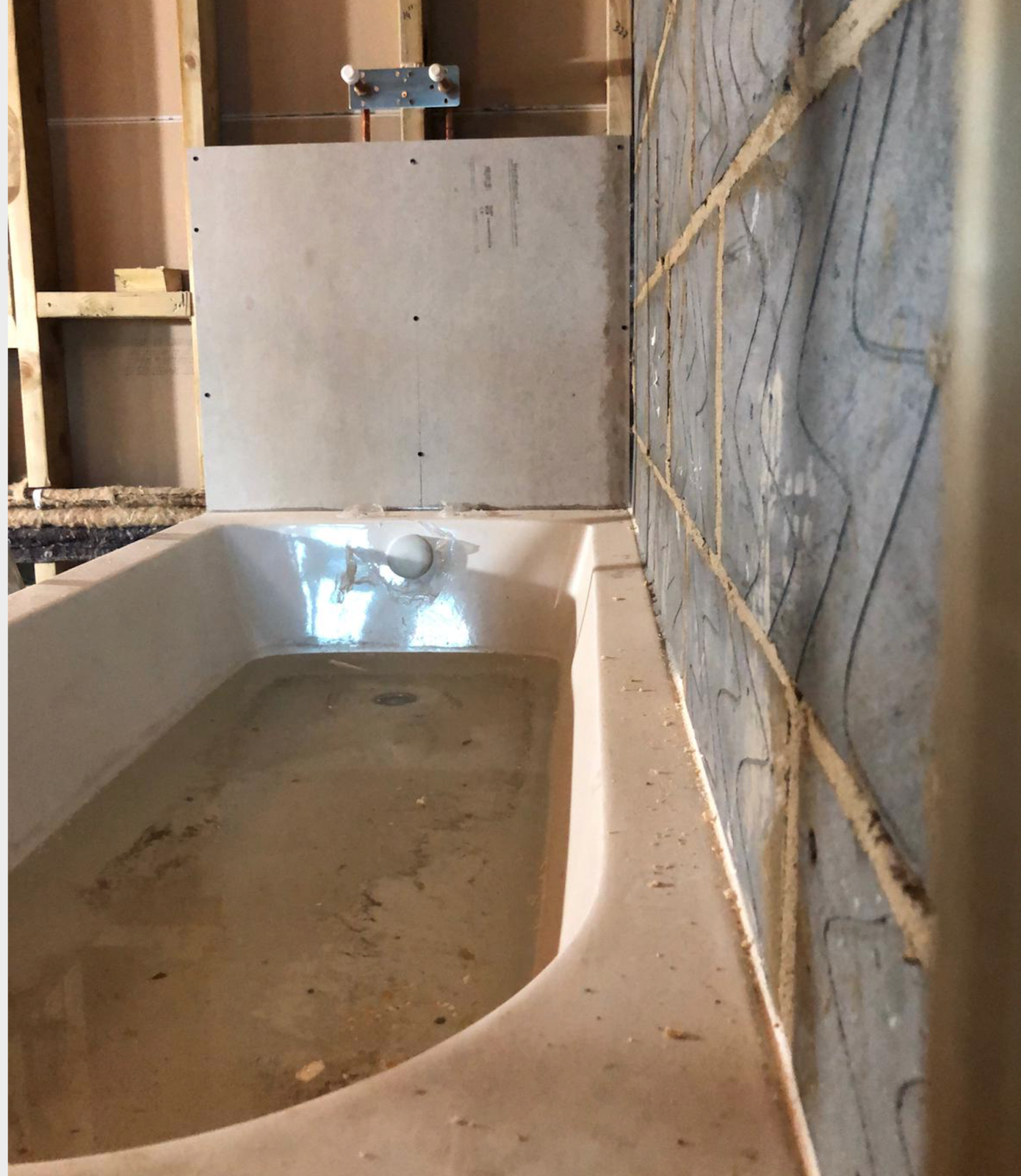

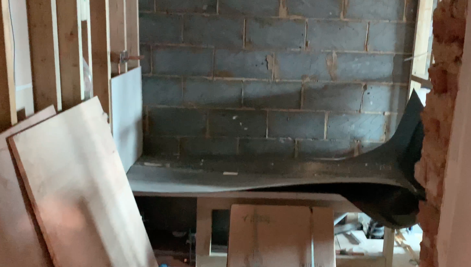

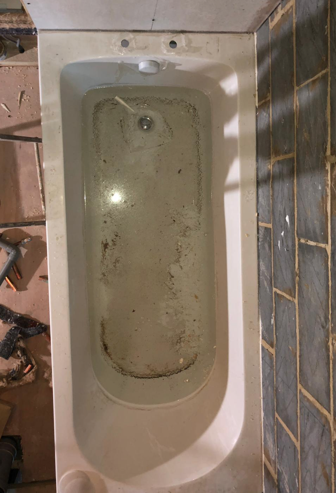

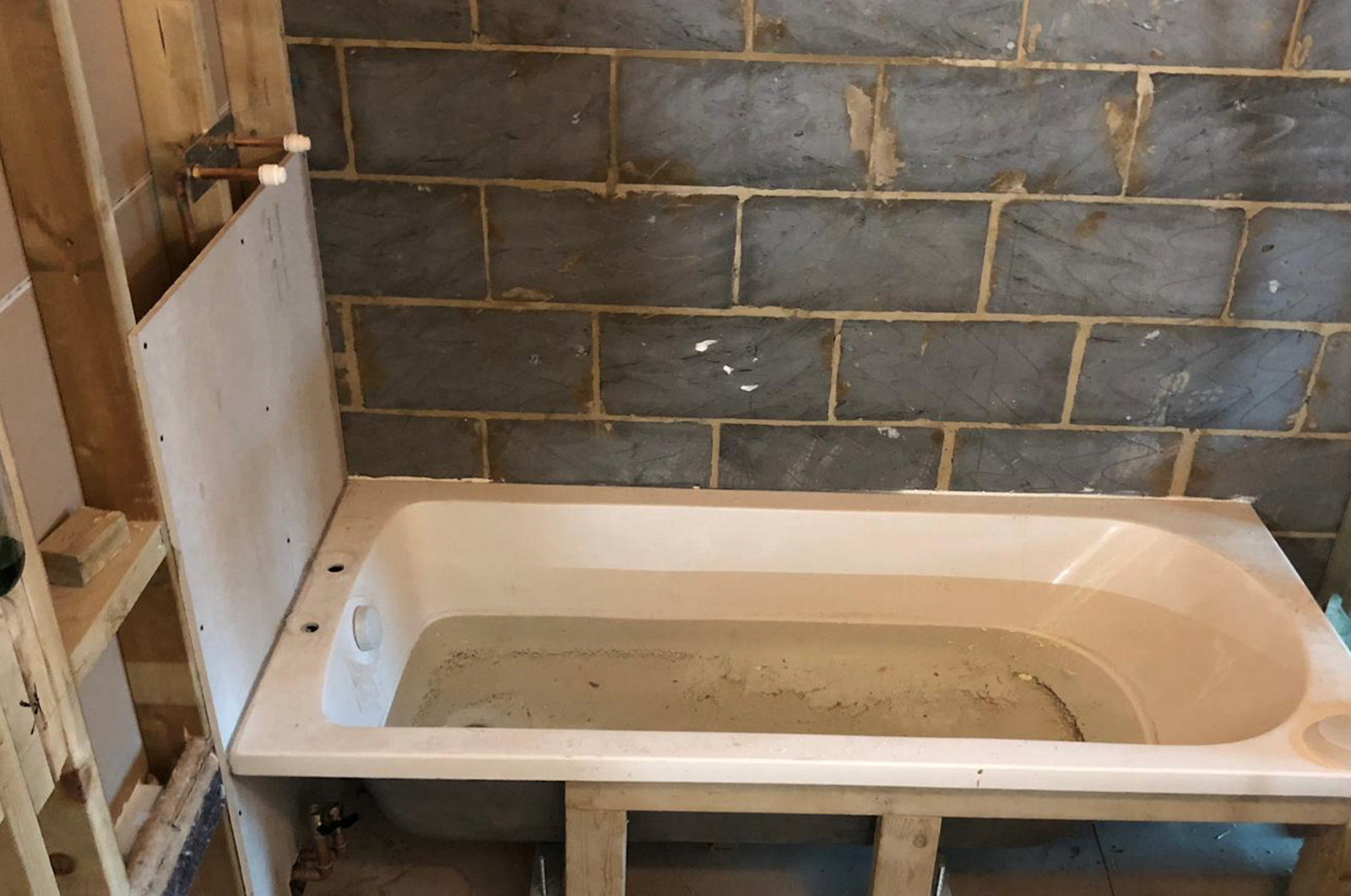

Hi I've only got a low res picture at the moment - the bath is against three walls - one is thermalite (the long side) and the two ends will be on stud partitions. They have put Hardy Becker board on one side and we will build out the stud slightly on the other

the pic isn't much use with the bath covered like that.
i need to see the full rim of the bath on all three touching sides.
if the panel below the valve can be removed that will help too.

OK apols - i'll get some better pictures and post them up tomorrow
your good to go either of two ways:
1. clean off the blockwork and take out suction, and then tile direct onto the raw blocks.
2. fix backerboard to the blockwork and tile over the board.
i'm assuming you've got backerboard below the shower ? - dont use plasterboard.
What do you mean by take out suction? So sand+cement not required before tiling?
Yep - it is the HardieBacker backerboard there on the studwall.
On the blocks side of the wall, there is no backer board behind the bath there
right, none needed. but if you want you could do the blocks in a 3:1 sand and lime render.
you take up suction with a spray of clean cold water and use bagged powdered adhesive
