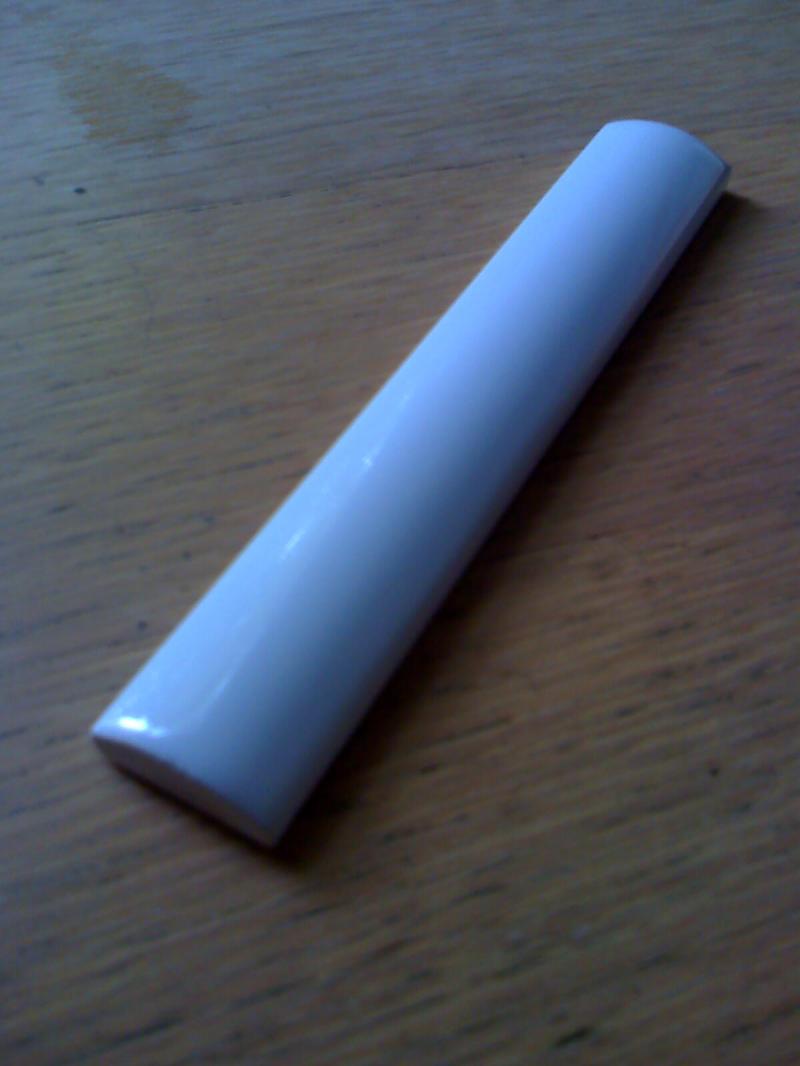

beatts - consider positioning the bath mid-way so you have a small gap (12mm) at each end. Tile down your wall then bridge the gaps with these:
bath edging tiles (or bevel strips) - B&Q and others do them in white or black. These are fixed, after the wall-tile adhesive has dried. Use white silicon to fix to the bath rim & wall, hold in position (to stop them slipping) with masking tape 'till the silicon dries.
You could, of course, use these to cover your single big gap at one end if you first fill the gap with a length of treated wooden batten, fixed to the wall.

I don't like seeing these little tiles bridging gaps - they're mould traps and places where leaks generally develop.
