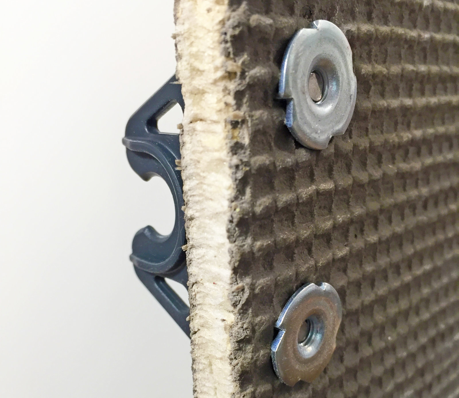

An old thread, but as I have just gone through a similar job, I thought I'd give you my 'pennies worth..
I used some Hardiebacker (or similar) I had lying around as a tiled bath panel, but rather than trust to screwing the Type 2 Fixes (Button-Fix) directly to the rather friable board, I used pronged M5 T-nuts (which are easily available fom ebay) poking back through the panel from the front; the tiles and adhesive easily master the slight intrusion of the T-nut. I used M5 x 12 Pan head screws to attach the Fixes. The result is very strong, and I'm glad I did it like this, as the Type 2's need a hefty pull to disengage.. not sure if a screw directly into the board would hold reliably.
I shall try and attach an image of a test piece I did to show what I'm talking about..
The Type 2 Fixes seem to cope happily with the heavy panel; I used six Fixes for the main panel, and four for the end panel.

I’m doing a similar project now, except I’m planning to use abacus elements bath panel board or the wedi board. I am having the same problem in that I think the screws on the Type 2 Fixes-from button fix, may just come straight through the board when I try to remove it with a suction cup.
How is yours holding up 2 years on from your last post? You used a Hardiebacker, do you think I can get the same job done with abacus or wedi? I’m not sure if these are as strong as the Hardiebacker when it comes to using the pronged T-nuts. Did you have issues with the pronged T-nuts? I’m afraid they may just pierce straight through these boards…

I've had absolutely no problems with the T-nuts using Type 2 Button-fix on the Hardie-Backer, they work great; they really spread the load and don't pull out at all. I'm not quite sure what the skin is on the Abacus, but the Wedi certainly will be fine as they have a fibrous cementious skin like the Hardie-backer boards. I would honestly think either will work very well. If you are very worried, it's a straightforward job to knock a little off the Type 2 detent clips, to reduce the 6Kg or so of pull-off force. They'll still happily hold up a tiled panel. As Godwasaplaster says, ply will work fine and can be screwed into directly; but it is heavier, and sooner or later it will get some damp in and will start to bow or de-laminate (marine ply included), unless you've gone crazy on the varnish preparation. Hardie or Wedi boards are lighter, cheaper, and just don't warp or bow at all.
