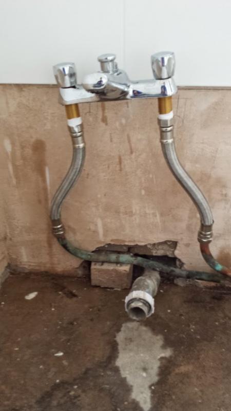

Cleaned the two pipes where I planned to cut the pipes, cut and fitted two full bore (not very) flexi hoses:
Yes they are a bit wonky, but I figured they'd be ok by the time the bath was in.

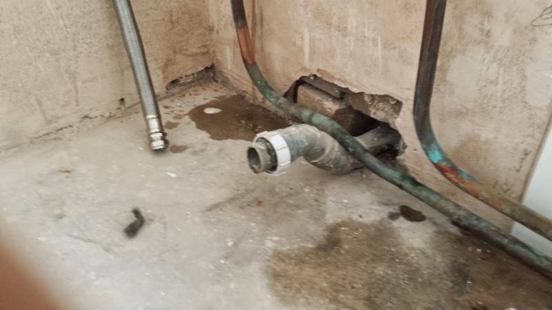

I also replaced the old grey waste as it had rotten through at the elbow outside.

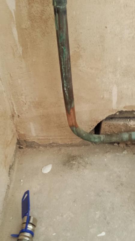

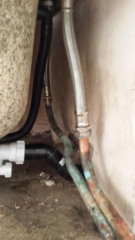

PROBLEMS!: The hot tap is leaking at the compression fitting. I had fitted a 3/4 inch olive and plenty of compound.
When I try to get the pipes lined up along the wall, the pressure of the tails is too much and is forcing the connection at the isolator to come loose. So, basically I have 2 leaks.
Behind the basin I also have a bit of a problem. When we replaced the suite about 8 years ago, we connected on to the two reducing tees with some new pipe work, although this isn't leaking, the joints are swivelling loosely on the old joints. The spacing of the 2 tees is also such that they dont fit behind the rear of the pedestal very well.
I am thinking now that my best option for long term reliability might be to move the 2 isolators to the pipes where they come through the wall into the room, then redo everything in the room with new tube and soldered fittings. As I don't have the tools and don't anticipate doing this kind of work, I'm thinking of getting a pro in. Do you think this is about half a day's work for an experienced plumber?
Thanks all...
22mm compression joins are quite difficult to tighten, particularly under a bath. It might just need a bit more tightening (no need to use compound) If olive is failing use some PTFE tape over the olive , not on the thread or replace the olive by carefully hacksawing off the old one.
You could buy a longer flexi for the one that is under stress.
