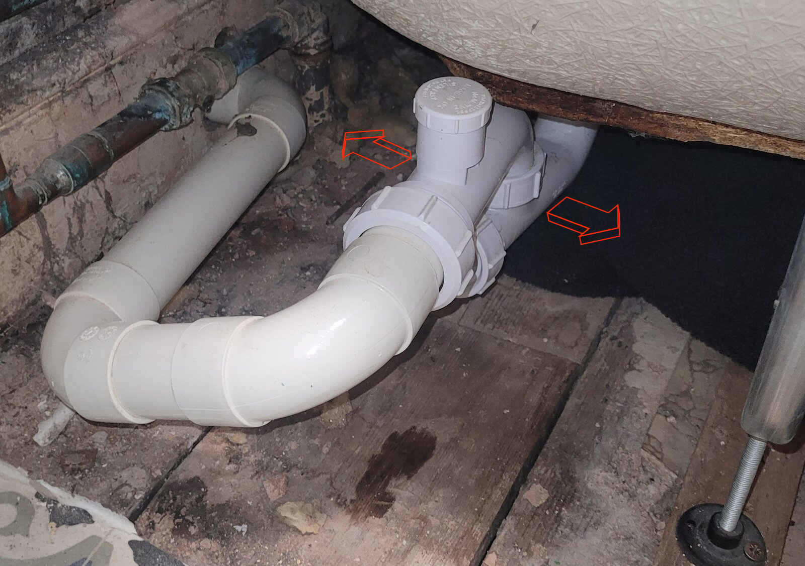

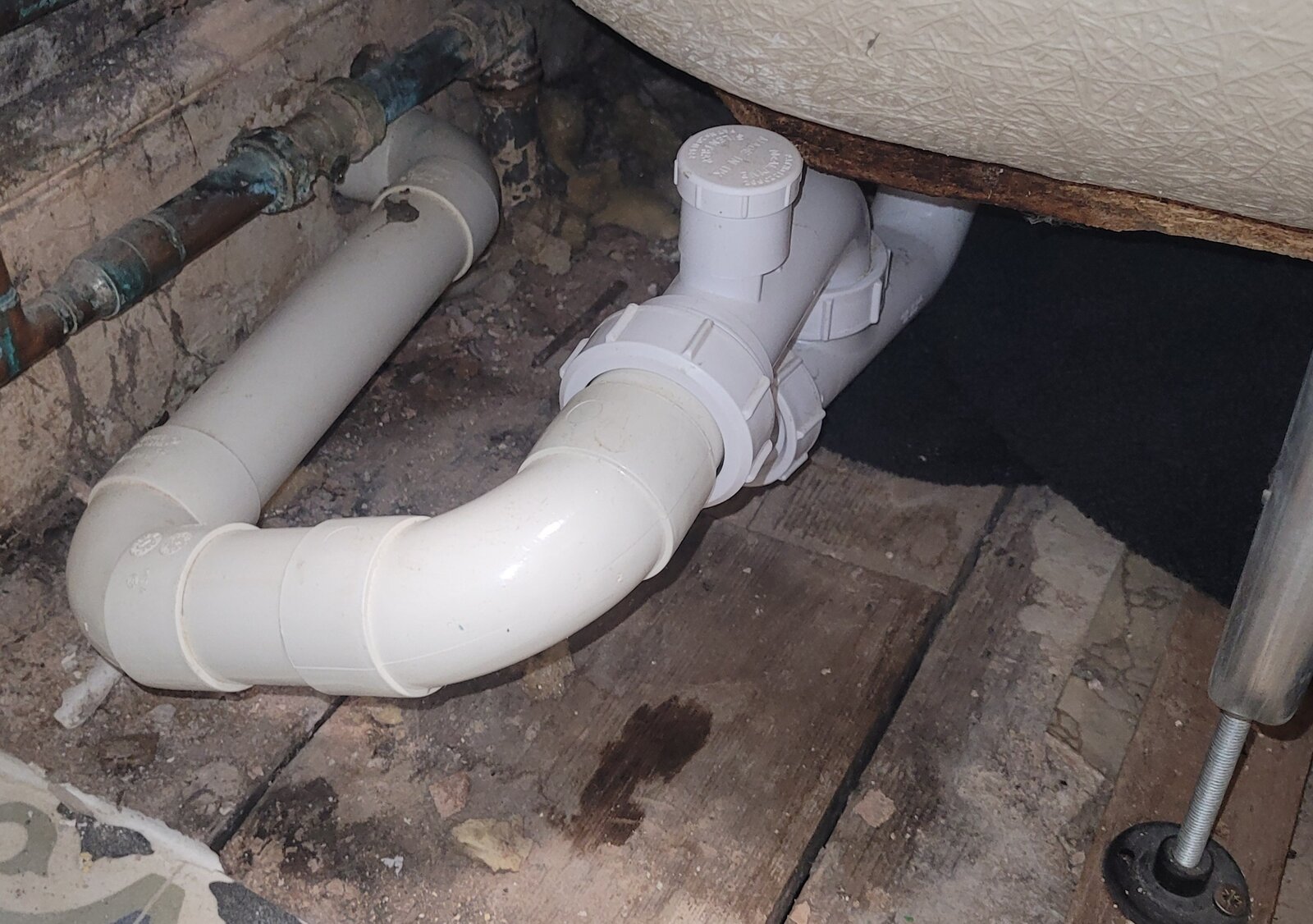

Hi guys a little help from any waste pipe experts here see attached photo
the current set up blocks the bath panel from going flush and is causing me issues I need to rectify but as you can see if I turned the trap backwards it would be almost touching the walls and I wouldnt be able to fit a pipe to reach the outlet any suggestions for me to make this actually all fit under the bath tub !
Loosen the nut that connects the outlet/antivac leg of the trap to the main trap body and loosen the traps waste connecting nut. Twist the main body of the trap right and then twist the outlet/antivac section left, that should give you enough space. If the Anti vac valve fouls the base of the bath then you may need to change the trap to a non vented type..
Thanks for the replys last post was gonna be my solution till I come across mcalpines bottle trap click plug unit under there nice and snug now
