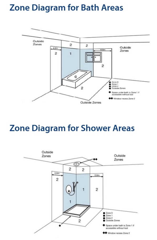

The problem you are facing isn't directly related to the voltage of the appliance - it is also related to the appliances IP rating, and what zone they will be installed in.
(Take note - many zone diagrams on the web are incorrect I.e. they show sinks as being in a zone, when they aren't)...
Here's a rundown...
In a small bathroom, a plinth heater may end up in zone 2; this would require an IP rating of IPX4, something a heater with open elements and a fan couldn't achieve.
On the other hand, a fan heater, mounted high enough, may be out of zone.
It is even theoretically possible to have a power socket in the bathroom; the room would have to be large, with the socket 2.5m away from the bath.
Also pull cord switches aren't a requirement in bathrooms - it's usually possible to mount a light switch out of zone.
However, and importantly, the supply to any new appliance in the bathroom should be RCD/RCBO protected.
...so depending on the size of your room, you may be looking at an IPX4 rated heater (low wattage tubular, oil filled, or a C/H rad, with a towel rail heating element).
Or a fan heater mounted out of zone, an IR ceiling panel, a slim over door down flow heater etc.

I'll try and get an image. I'll check with my electrician but the area under the sink cabinet is definitely more than 0.6m from the enclosed shower or the bath.
I guess another question is, if they sell IP22 rated cassette style electric heaters which have a fan pointing down, is there any reason why they can't be mounted so the air comes out horizontally? This could then be set back under the cabinet, well away from any potential splash
