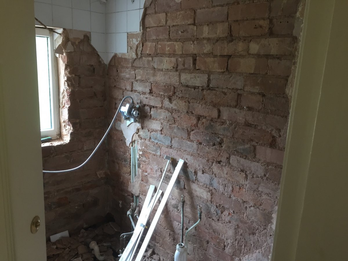

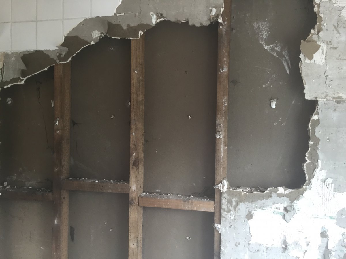

Hi first post on here I've taken the bathroom back to Brick to retile around bath and splash back and plaster the rest. What are my options for replastering. I have one stud wall to re board and three brick walls. Am I better off dot and dab boarding it then plaster or can the plaster just go straight onto the brick.

I'd definitely dot and dab board it and then plaster straight onto the board then that way you will end up with a better more level finish!
I did this last year and re-plastered the brickwork. We left it as a scratch coat where we were going to tile and it provided a nice key for the tile adhesive to grab to.
It also means if/when we slip or fall out of the bath or on a wet floor there is no chance we'll dent the wall! I know that's very unlikely but could happen with plasterboard and the walls feel more solid. Another deciding factor for me was that plasterboard doesn't last too well when wet!
I'm happy with the result.
The stud wall will need to be re boarded, when you have done that if it is in the area of the shower then I would use a tanking kit to make it totally waterproof
As for ease of installation and speed then dotn dab would be far quicker you can board it all one day and start to tile the next
If you are a decent plasterer then Bonding or Hardwall is an option to plumb the brickwall and 2 coats of skim for finish
The first choice is quicker and easier and requires very little skill ,the second you will need decent plasterer
