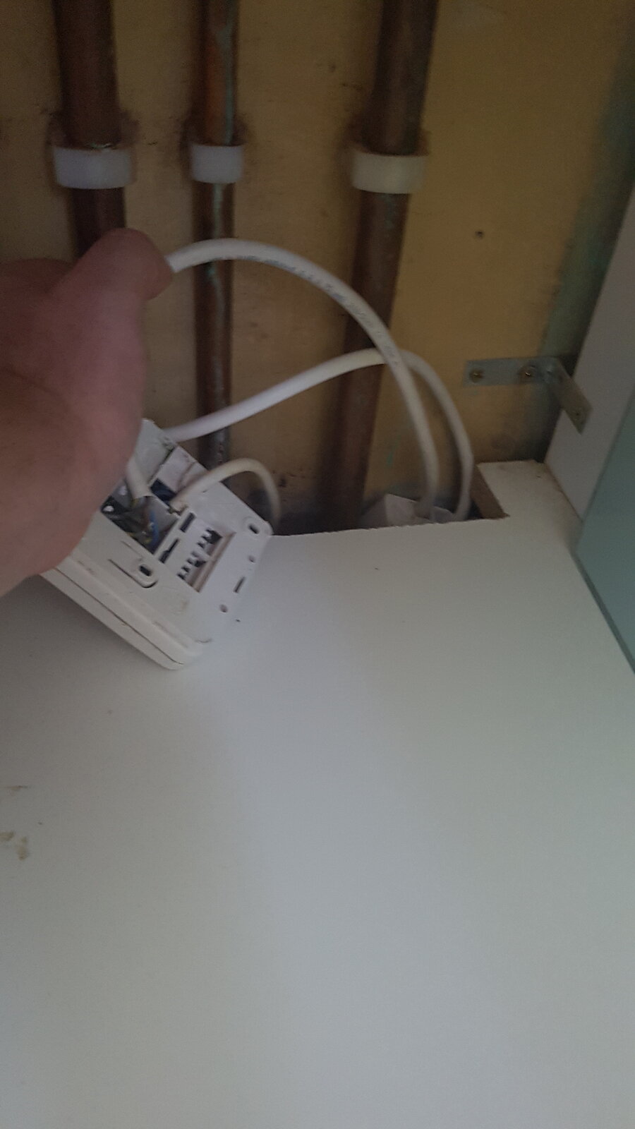

I've found whoever installed the boiler (in 2018) has taken a power feed from somewhere under the floor, into a switched fused spur, which is laying loose on the floor under the cupboard.
Power from here goes to a Honeywell wireless receiver, which is also laying loose on the floor. Power from this goes to the boiler.
My first question is surely this is unsafe, and both units should be screwed to the wall inside of the cupboard. Basically not on the floor of a wetroom. Are there any rules about placement within the cupboard (e.g., should they be a certain height off the floor, or, not directly under the boiler)

Yes it needs correcting, and items do need fixing to something to stop cables being pulled out of the items on floor, but as to if dangerous without pictures can't really comment. It may be safe, it may be near criminal, but without pictures or being there I can't say.

Spur below, but loose, under bottom shelf. Cannot be bothered to take apart to demo, but pic shows it loose and the cable management.
Both items had been stuffed down there, out of sight
Not safe. Both units should be attached to the wall, and the cables cleated.
The way they have been left, there is nothing to stop the cables being pulled out of the terminations.
