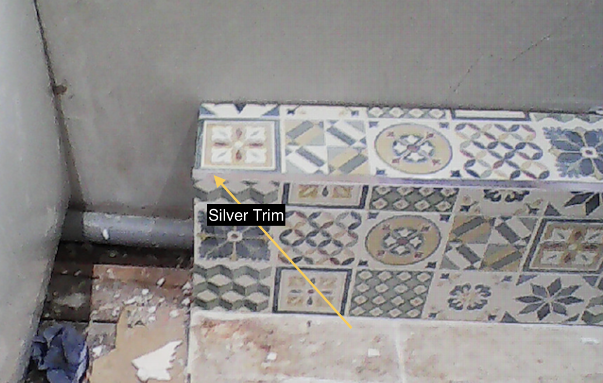

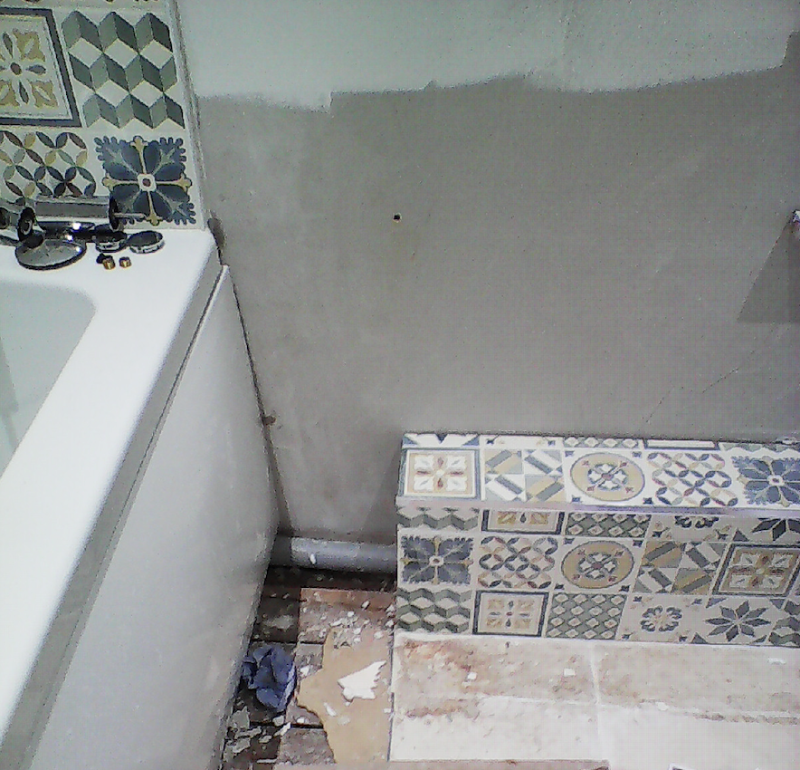

Had a tiler come out to tile the boxed area where pipes are hidden however he said he couldn't finish to the bath because there needs to be access to the pipe. I had a shower tray fitted before I had the bath done and the tray went flush to the boxed in area so not sure what he meant. Any ideas of how I could hide/box it in. I really think it would have looked much neater being flush with the bath.

You're right it would look neater , there is nothing stopping you completing the boxing in but leaving it unfixed so it can be lifted out if you need access to the bath panel
Thanks. Contacted the tiler and said he will come out and do it. He will need to continue the silver trim will the join be noticeable do you think?

If he's good it will only be noticeable to you , and that's only cause you will know it's there
How will you get the bath panel off? Cut a rectangular hole in the corner?
I
I believe the op is going to do my suggestion of continuing the boxing in but leaving it unfixed so the boxing in can be removed if the bath panel needs removing
